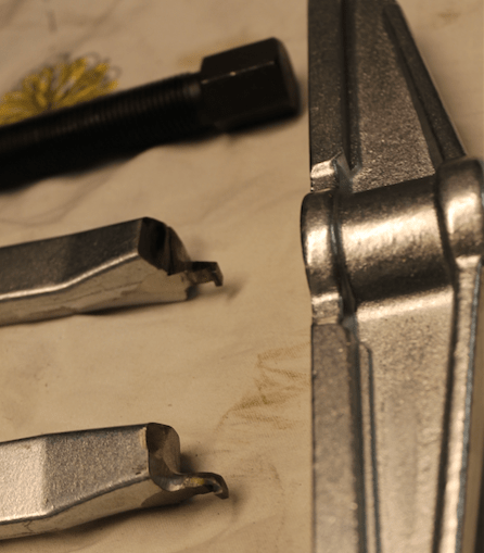

2)Puller for cylinders can be modified of a cheap puller

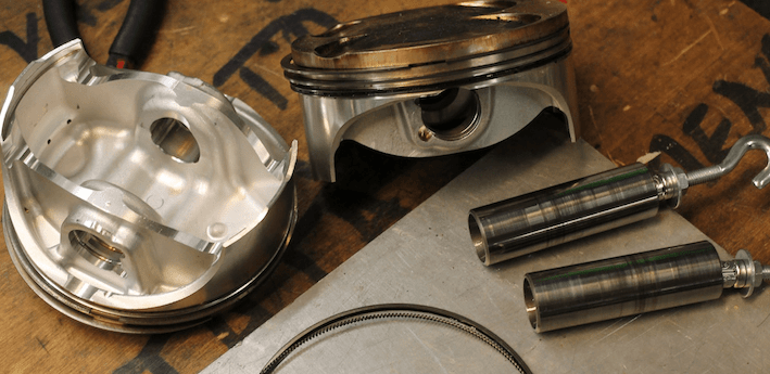

3)Piston pins was very tight so these 'tools' was needed.
(see pictures below)

1) Rear piston oil ring is broken.

4) Piston pins have some coloured marks on them.

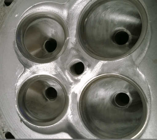

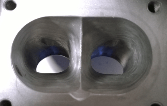

And the most beautiful thing! Initial porting and combustion chamber cleanup done. Next step is to bring heads back to shop and they continue with porting and do proper valve job.

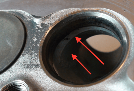

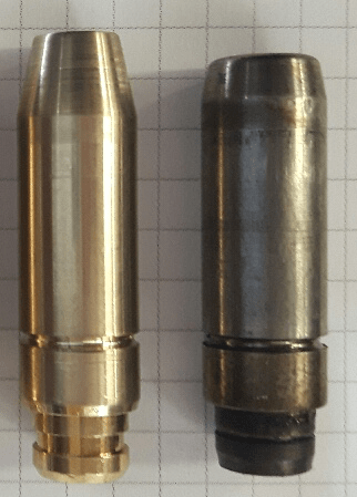

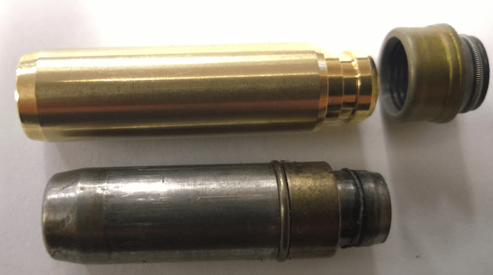

Heads dropped for professional treatment. Next will be new valve guides (Renaul/Nissan/Dacia 1.5 Dci K9K) They are ,02 thicker cause of more slippery material, little longer which does not harm and lack original lock ring. Guides also has good quality seals. Cause of this they need a minimum amount of modification: Similar lock rings will be put on them as originals and cone done on lathe.
Groove must be done so that upper end of the guide is at same level or lower as original!!! Otherwise retainer may hit the valve stem sealing when on top of the lift
Did a new inspection for pistons and found some places for improvement. There is minor darkening and scores in the middle of wrist pin and this i like to polish away gently. This might be cause of pin and connecting is of same material and do lack bronze bushing, which do not sound as very good idea. Luckily this can be solved with DLC coating and is is not even expansive, but wrist pin must be in absolutely top condition. Surface must be mirror like. Lets see if it can be achieved…
In future, if piston change becomes acute then DLC will surely be applied on fresh wrist pins.
https://www.oerlikon.com/balzers/de/de/ ... chichten/

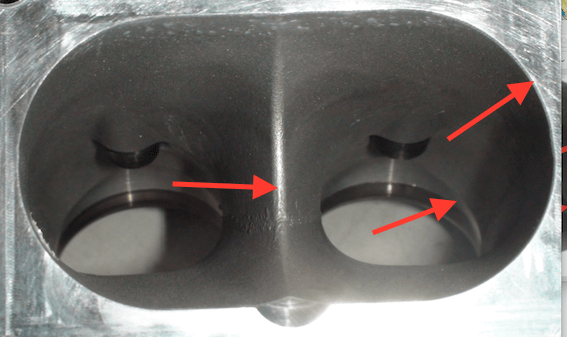

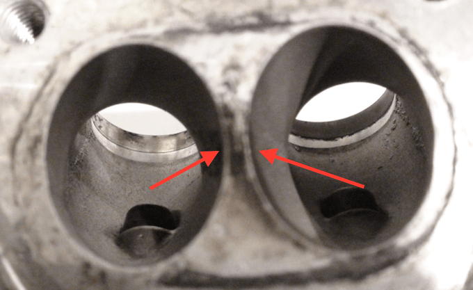

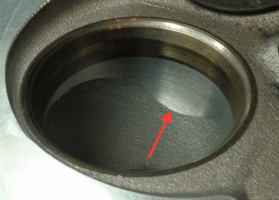

Did put two exhaust pictures here too. They show most important places for modifications. On Exhaust1 picture there is protruded area in need for removal (2-3mm) You can feel it with your finger and sharp edge you can see with bare eyes. Similarly on Exhaust2 picture there is a weird group whic directs exhaust gases against header walls. Very easy to remove if you find it with your finger first and check with some straight too to be sure it is removed. Best achievable exhaust flow path is more difficult to figure out cause of change from round valve to curved and oval channel. Intake is easy. Just do not enlarge but blend and make smooth and straight.

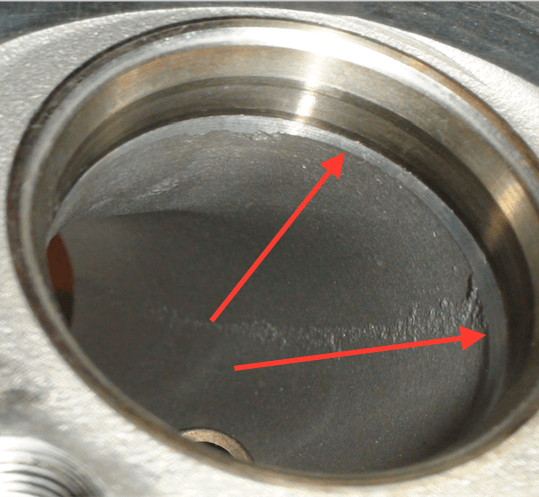

Grooves and cones done on new bronze valve guides. Pictures of DIY porting or rather smoothing and better fitting parts together. Took maybe 4h
Finishing is done by pro machinist. Peter will sharpen the intake dividers and glas bead blast intake channels.
Hope someone can measure the correct height.
