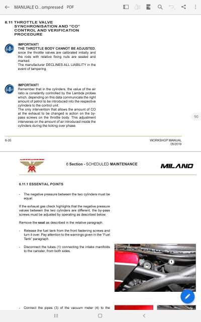

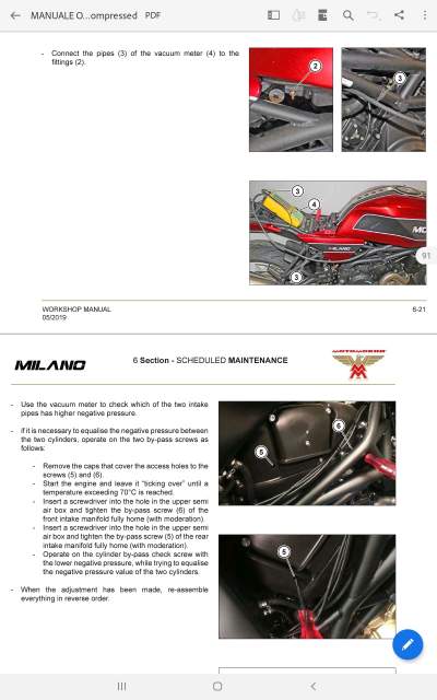

Hello,
If I remember correctly, you should screw in both screws to the stop and then only adjust one screw.
I have attached two screenshot from the Milano manual...
The quality is poor due to site limitations. If you have difficulty reading the screenshot let me know and I'll attempt to change the quality.
Lykke til...
Mike

Hi , I have the workshop manual for the 9 1/2 so thats ok
Thanks for the info - I have used the correct prosedure - I have to take a new check
Wish me luck :-)
