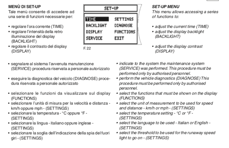

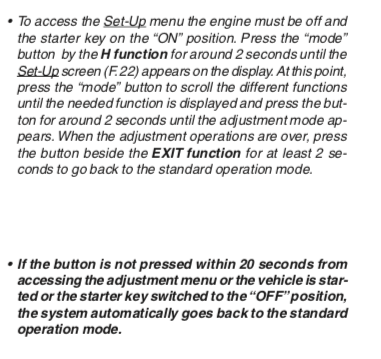

The ‘injector warning light’ is not just for the injectors, it’s a diagnostic light a bit like the MIL lamp on any modern car. It will illuminate for basic electrical faults in connected sensors as well as more fundamental faults like as you say faulty injectors.
There is a diagnostic menu you can access on your dash board which will tell you what the fault is. I would do that before spending any money. This is detailed in the workshop manual. As twisty says, you can access the menu by pressing and holidng the dash button with the ignition off and then turning the ignition on whil still holiding the dash button. For 1st series Corsaro it is described in the manual as in the attached screenshot (although doesnt mention the ignition off bit, which is required for the diagnostic menu to be accessed). 9 1/2 will be the same.
If the dash diagnostic doesn’t tell you then you can get a bit more access by buying the correct interface lead and downloading a compatible software such as Guzzidiag. See December 2022 ATG where I described this process
