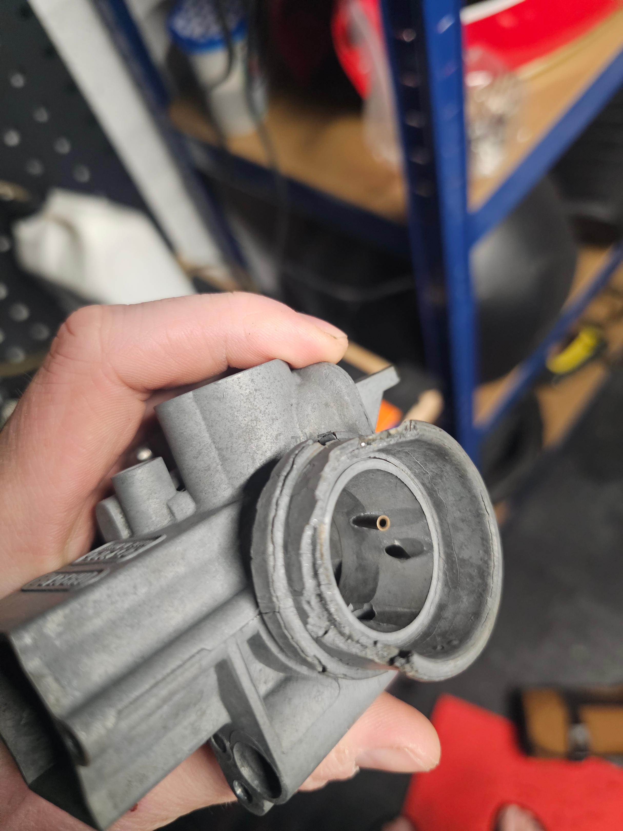

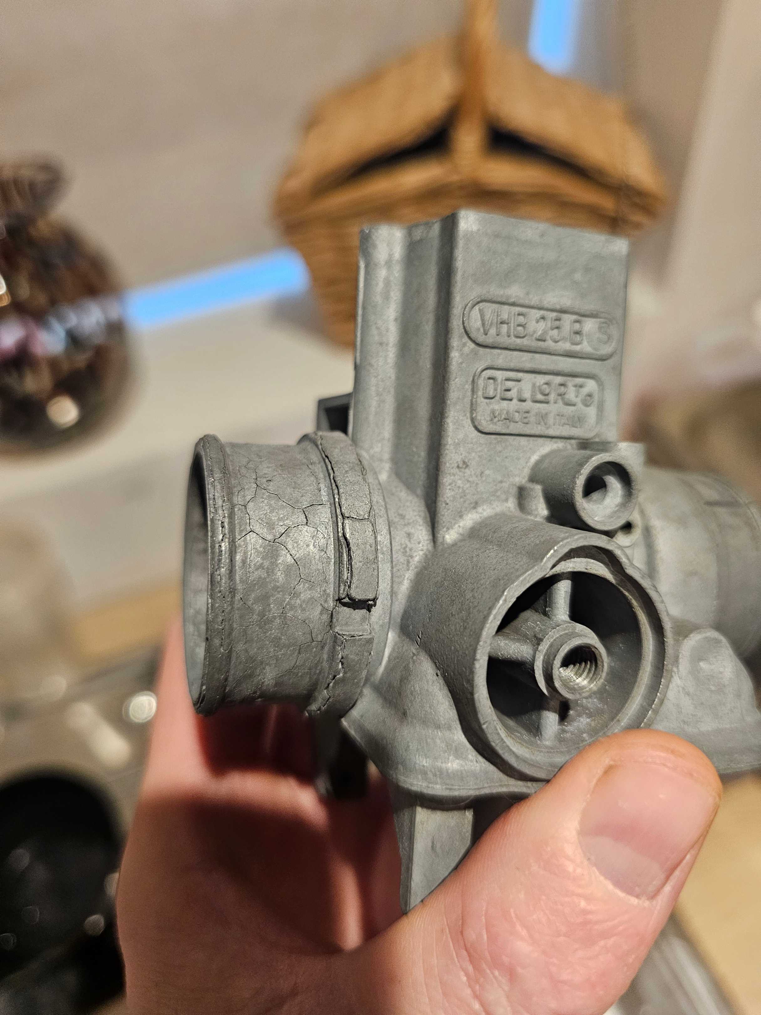

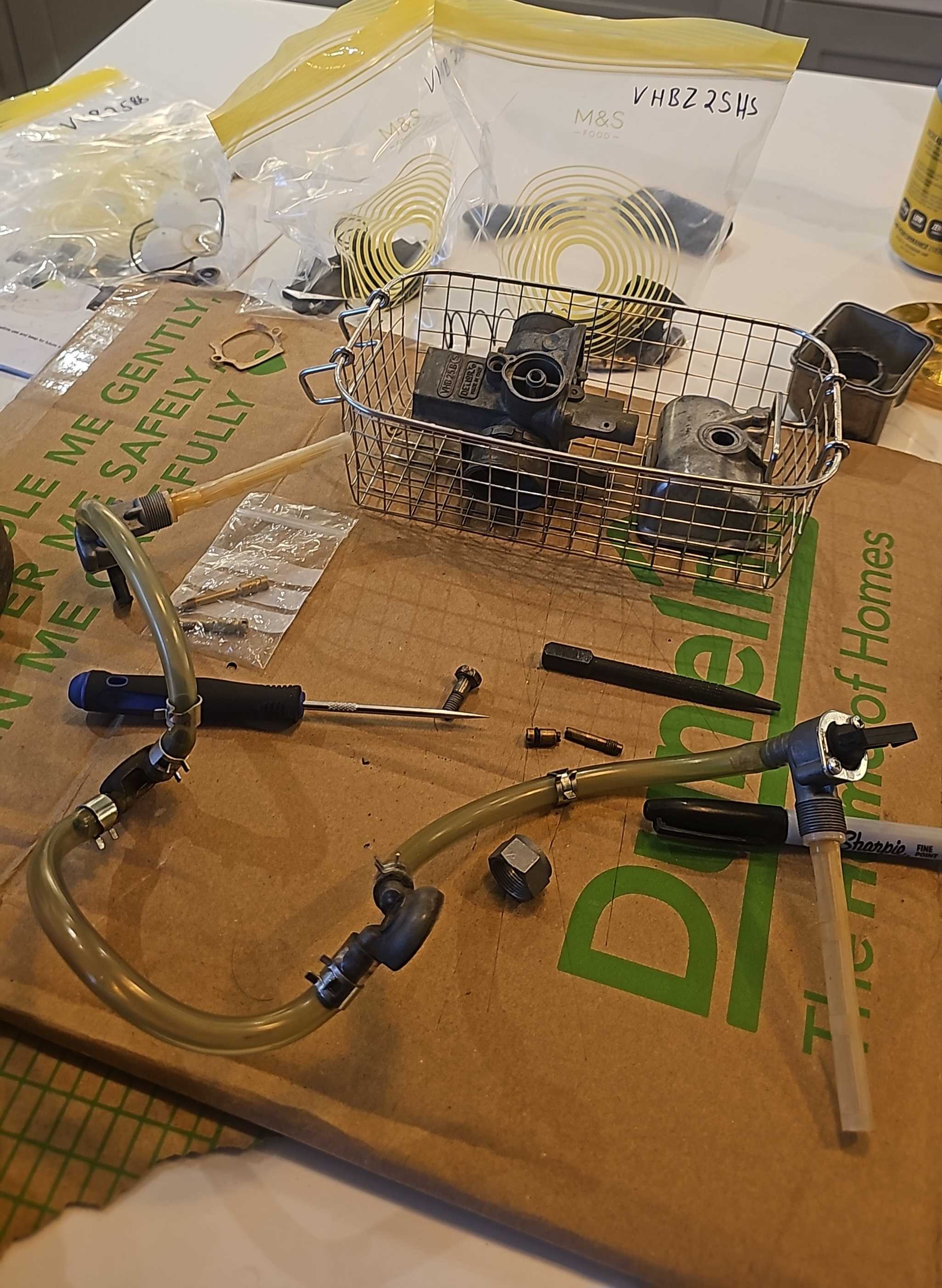

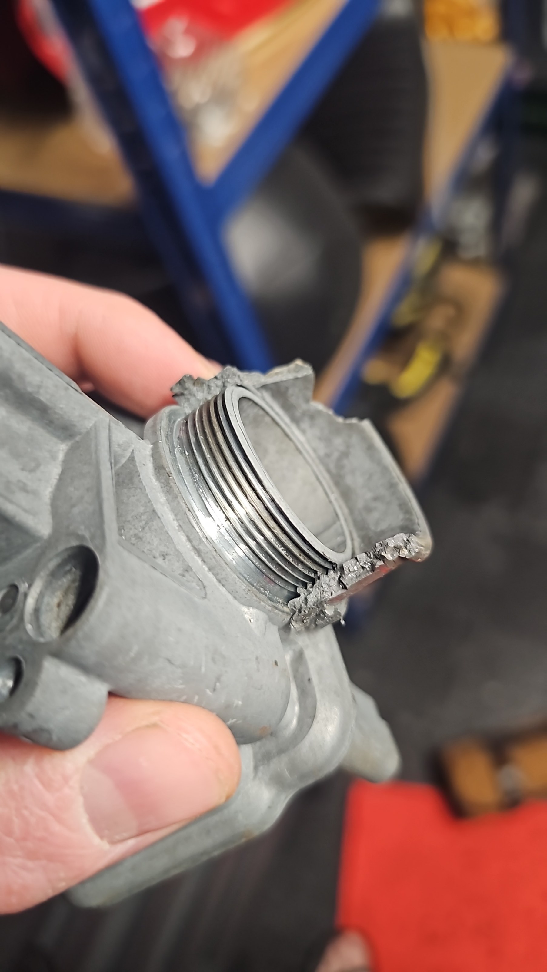

Im back! Update is dads Morini was in storage with a friend while i was building my house, im now on with the rebuild, cam belt and oil change is done.
Spent this weekend stripping and ultrasonic cleaning the carbs, catalogging whats knackered and beginning to order everything.
Im going to try and eliminate all possible issues, had a stubborn carb trumpet which i put into the vice with soft jaws it just crumbled like a piece of stale bread.
If i can firgure out how to upload photos (its saying they're too high mb to upload?) Ill do that as i go cheers

The crumbling carb trumpets on the early carbs is sadly quite common. They are made of zamak or similar which seems to corrode and crumble over time almost without fail. My advice is to replace them with the plastic trumpets from the later carbs- a straight swap- before the engine ingests a wayward chunk.

Re: 1975 3 1/2 Sport
I have got them on my order list, it mustve happened on one previously as the other already has a plastic one
