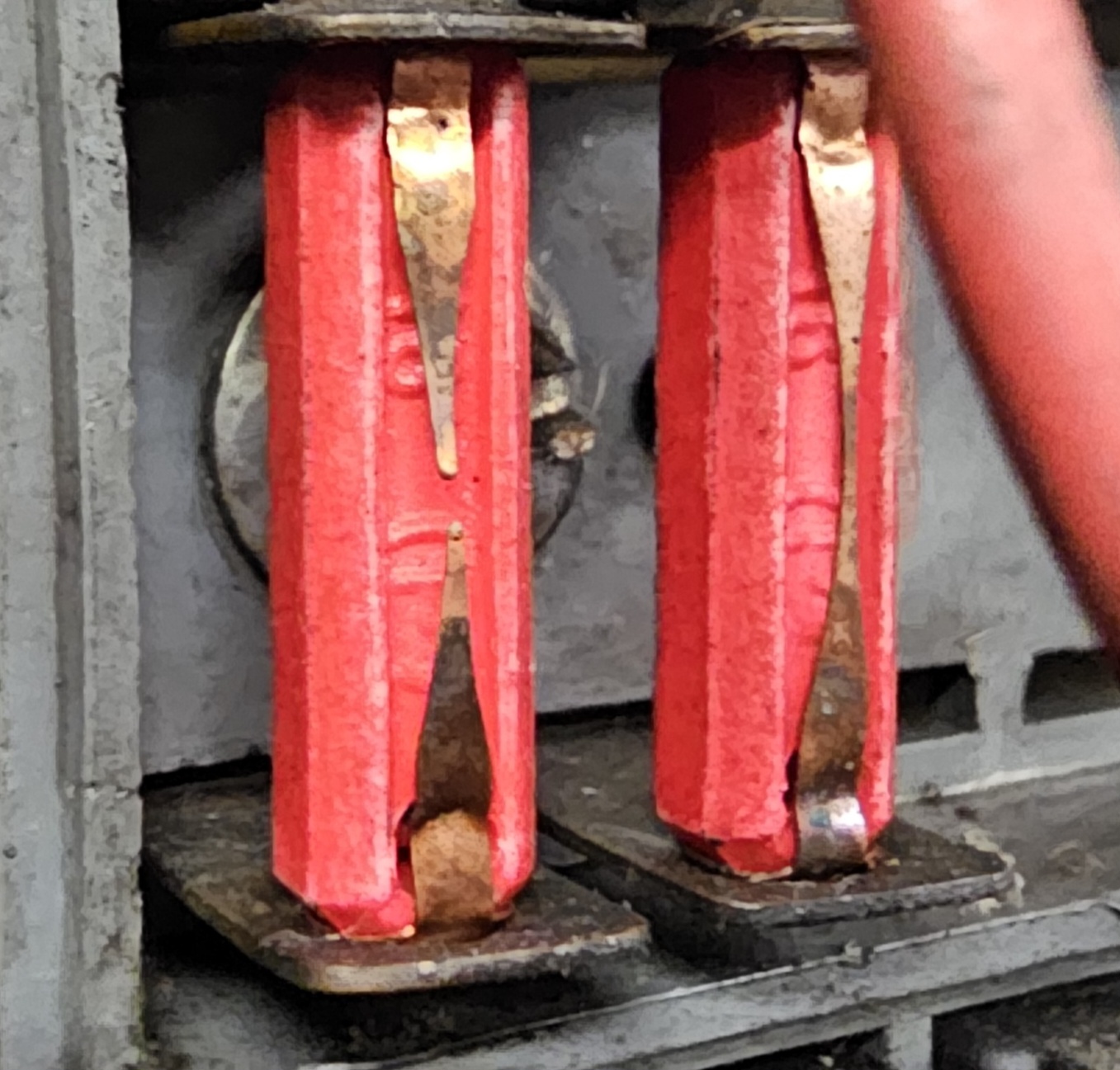

Next up is the fuses, from what i can find they are ceramic continental fuses? But i have no idea ive never seen these before im guessing its the reason i have no tach or lights etc. If anyone has some info it would be greatly appreciated.

Sadly local decent automotive factors are becoming a thing of the past. Nowhere near me so I bought my last lot of fuses from EBay.
If you search for ‘automotive bullet fuse’ you’ll find what you need.
The fuses in the fuse holder should be tight. Often these go sloppy over time which doesn’t help with electrical gremlins. You can bend them a little to restore some spring, but when they get to that stage I tend to take the whole fusebox apart as if they are loose there then normally the rivet joints behind the spades are also loose or corroded too.
Best solution is to disassemble the whole fusebox by drilling the rivets out, cleaning up, then re riveting (or bolting with appropriate locking nuts and epoxy to stop them coming undone) and if you really want belt and braces, soldering the joined terminals too.
With the above job done properly now you’ll probably never have to think about it or check electrical conductivity in there again

My local Halfords used to have them when I last needed some - it was the easiest option where I live- they still have them to order in - type in continental fuses

Thanks for your help, ended up getting same (but in a different metal) and i have working ancillaries now.
