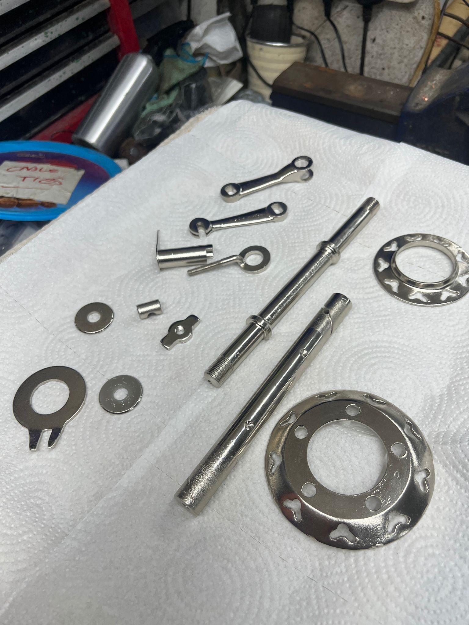

Just a little update, wheels not fully stripped and we’ve started to plate some of the parts.
I’ll be sure to pop some more pics up soon.
Arthur Farrow
Posts: 146
Joined: 24 May 2008 09:09
Re: 125 2T
Post by Arthur Farrow »
Oh that looks posh
I would have masked off the spindle areas where they cannot be seen/go through bearings to ensure you do not get minor interference.

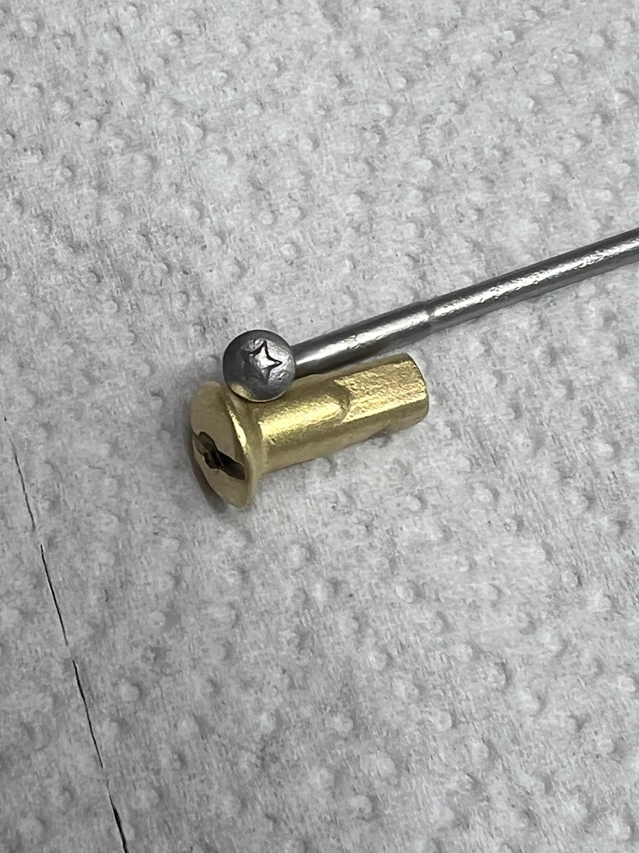

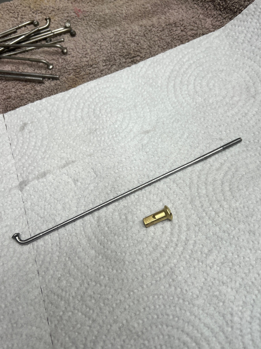

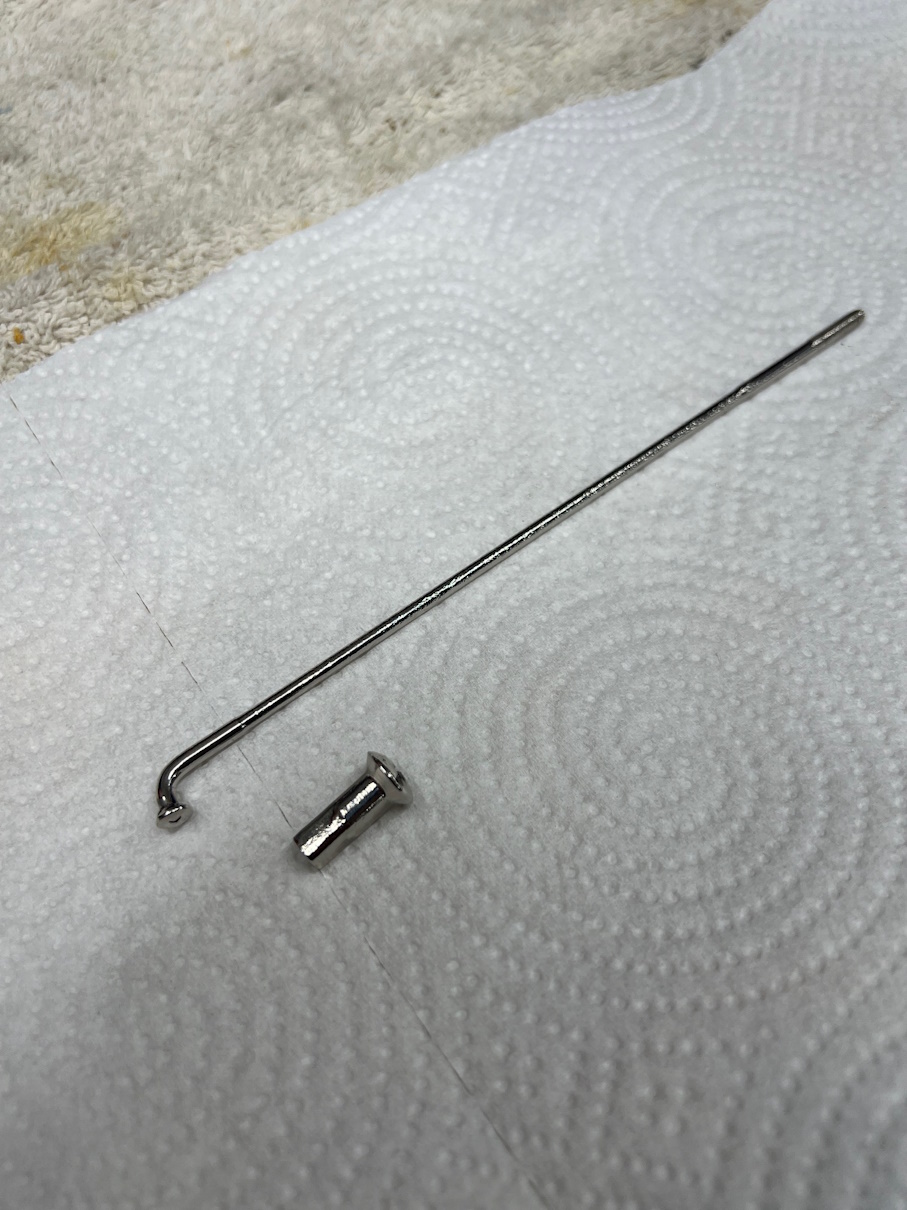

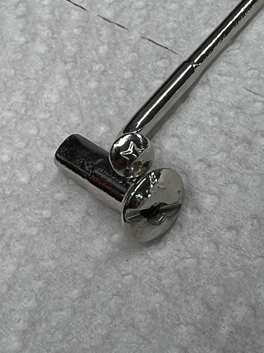

Ok test for amount of nickel plating time so as not to cause an issue with the nipple threads being too tight on the spokes.
A 40 min plate for both spoke and nipple @ 700ma. All was good
