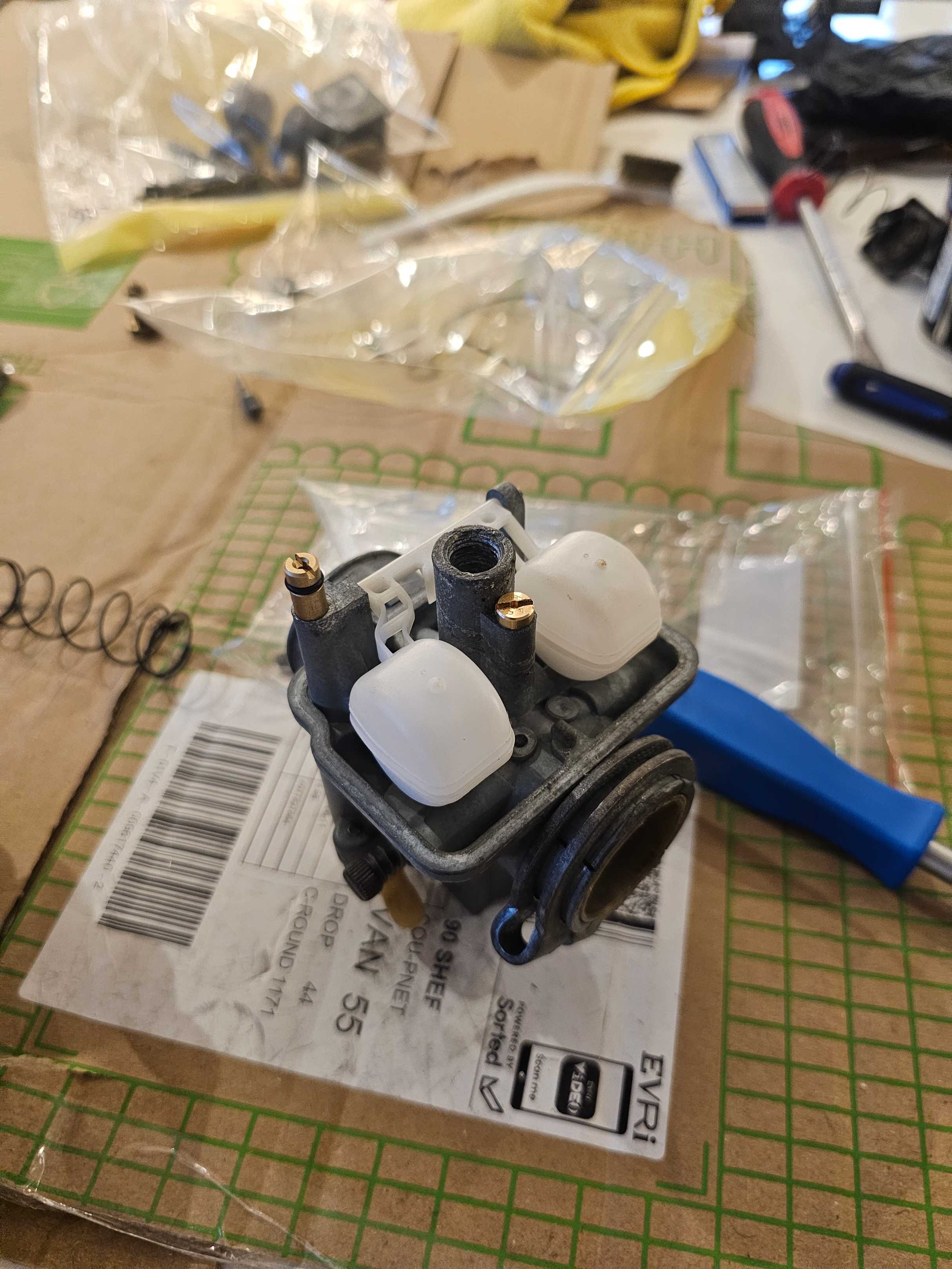

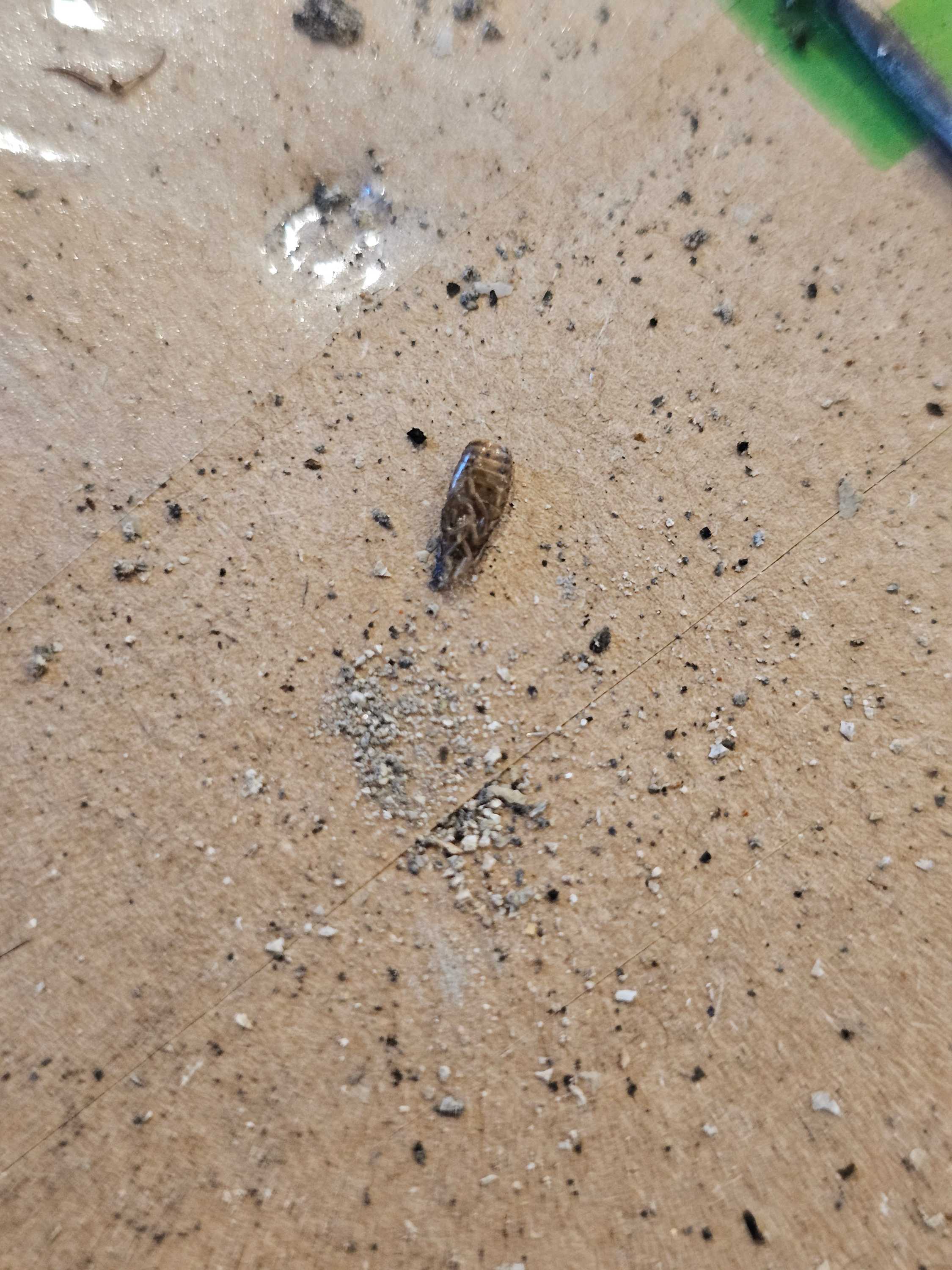

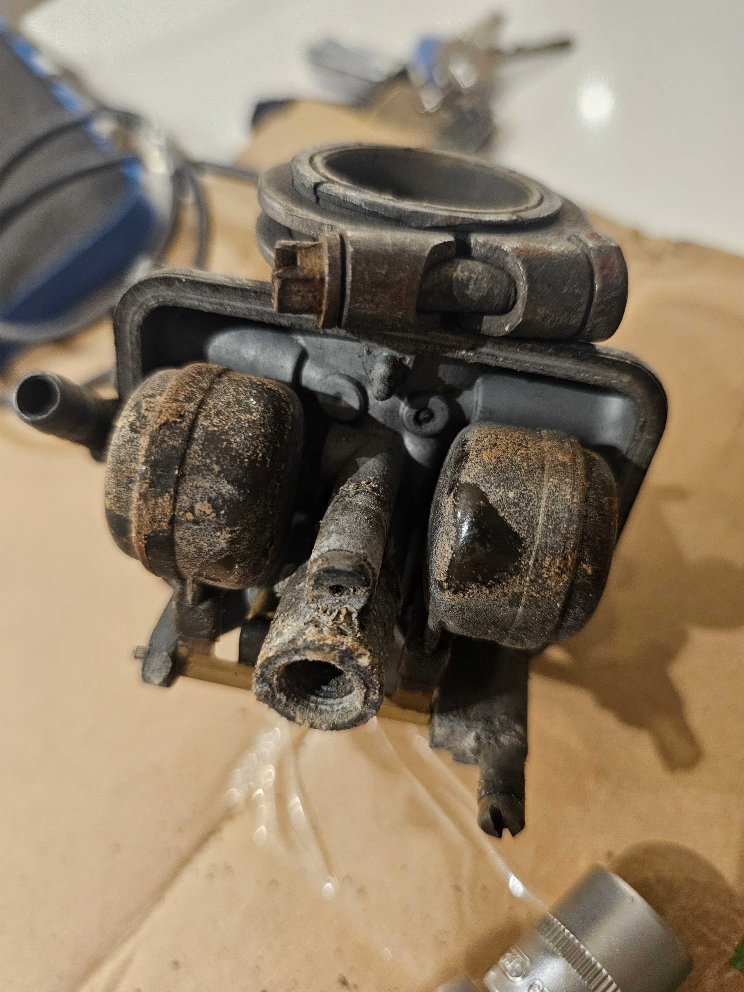

Thanks everyone
Its been quite a journey to get to here, i ended up destroying a carb trying to retrieve a snapped screw out of it.
It ended up being a blessing in disguise as it was a VHBZ25HS which didnt match with the VHB25BS which I'm guessing is why my dad always had issues with it running/not running and braking down all the time. I obviously didnt know this, i had it as it came to me and just assumed thats how they were.
So it now has a matched set of VHB25BS, one of which i found on Ebay had to strip and clean as it was in a very sorry state (it had a bug in one of the jets) refit all that.
I didnt realise that the kickstand was fouling the footpeg and when i kicked it i snapped it clean off so ive anyone has a Tarozzi lever arm lying round ill take it off your hands.
So happy to have it running besides my previous attempt 2 years ago, i dont recall it being run or ridden in the last 10+ years.

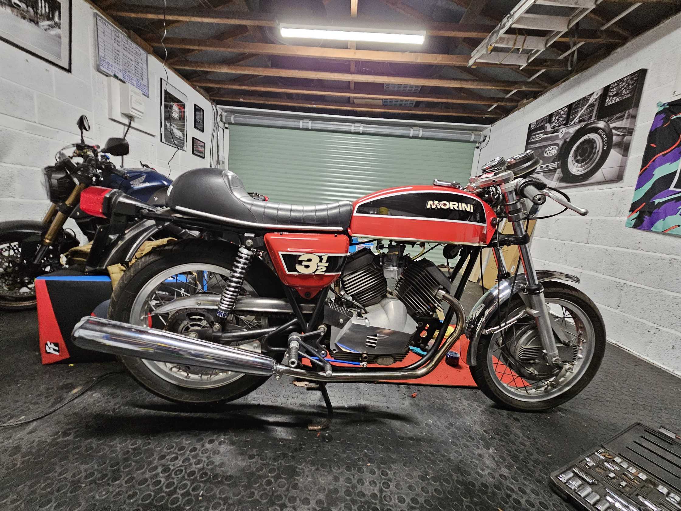

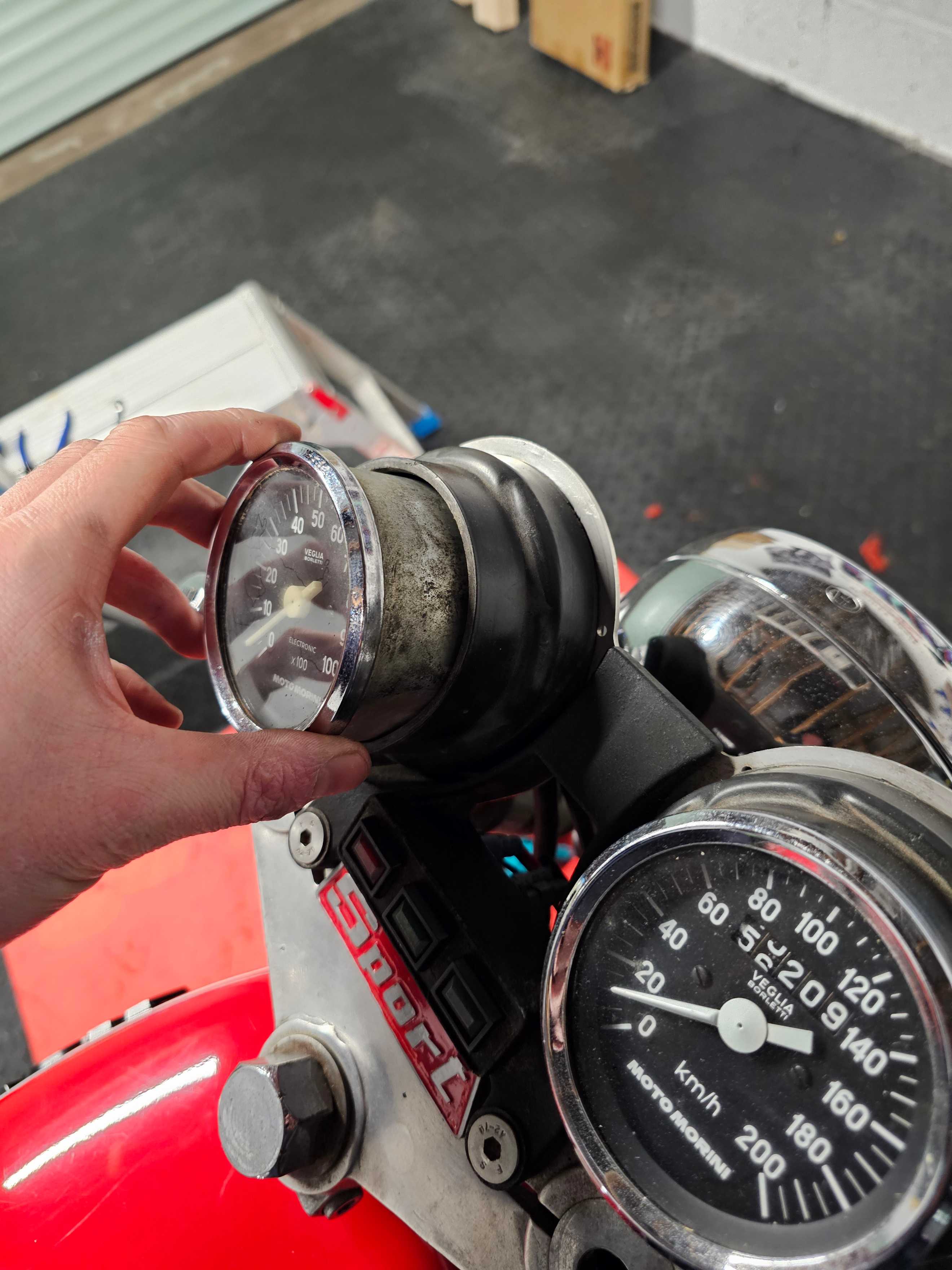

Re: 1975 3 1/2 Sport
After celebrating getting the old girl going again i decided to throw everything on that i've got today. I also put on a bit of Lanogaurd rust treatment on some of the more soiled bits
Found a few bits missing which i've posted on the wanted bit, i've started on with cleaning it up a bit after discovering that that there is actually meant to be some polished parts to this bike besides the headlight and mud gaurds! The near side still needs a little bit more work, but i got distracted by starting on the wire wheels which are a bit of graft
Can someone tell me if the clocks just sit in their rubber housing? If they do how are you rectifying them coming loose?
Cheers!
Cheers!
