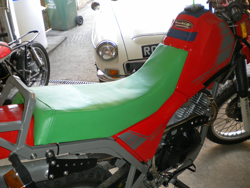

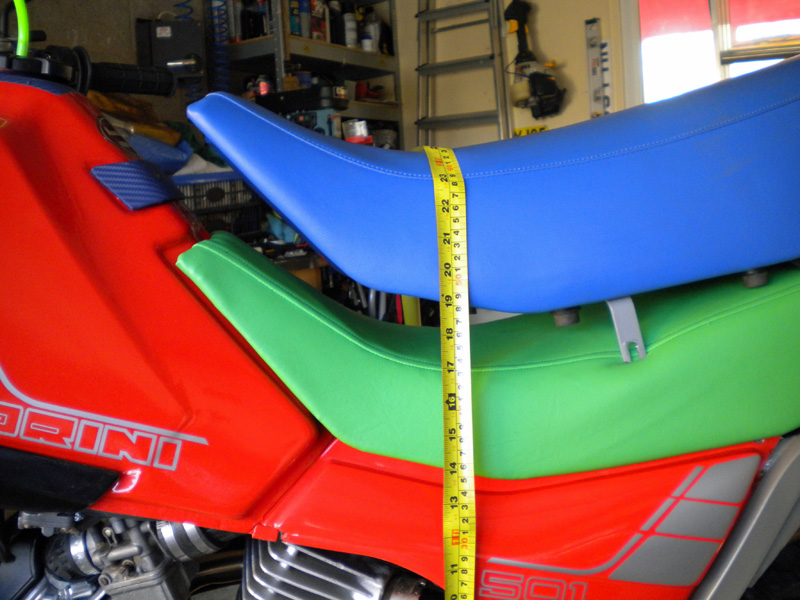

I haven't got anywhere with the Camel front cylinder yet, but I have managed to finish the seat Hans sent me from Holland.
It is at least an inch lower than the original and thus makes it easier to climb off.
I did the work on the seat myself, it's a first attempt and I'm not happy with it, but at least it has finished Kermit off. Thanks Mike.
You can see ripple where the seat foam has been cut and the stitching will be better next time.
Next job to sort the burning oil and the 5000 rev die back.

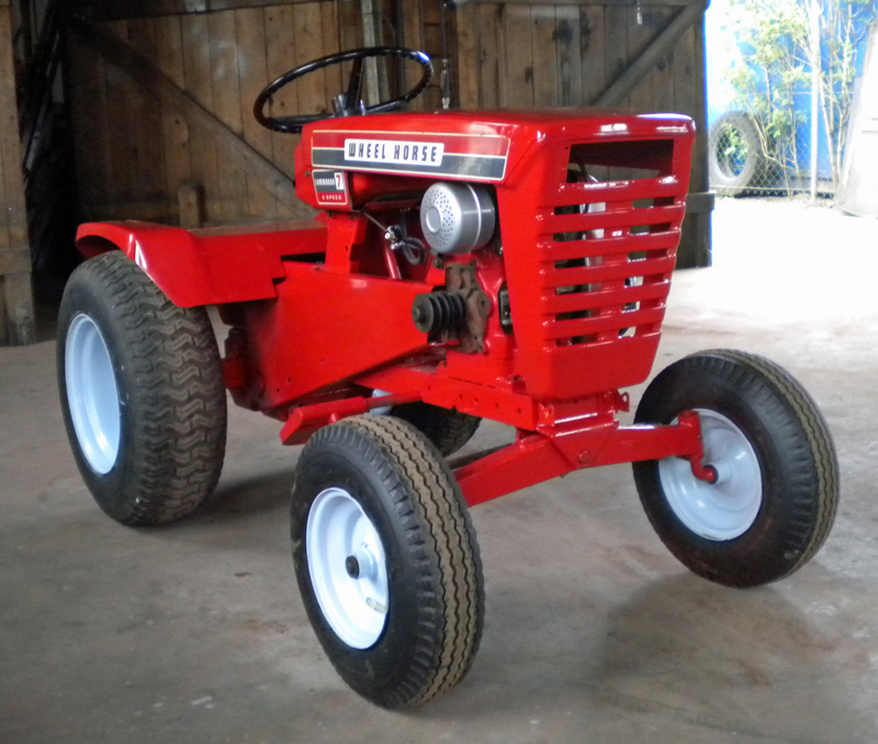

I have been busy again with this little Tractor, Wheel horse Commando 7, 250cc side valve 7HP, love it almost as much as my Grand daughter.
American engineering at it's best, sounds like a single cylinder Harley and it is Agricultural.
