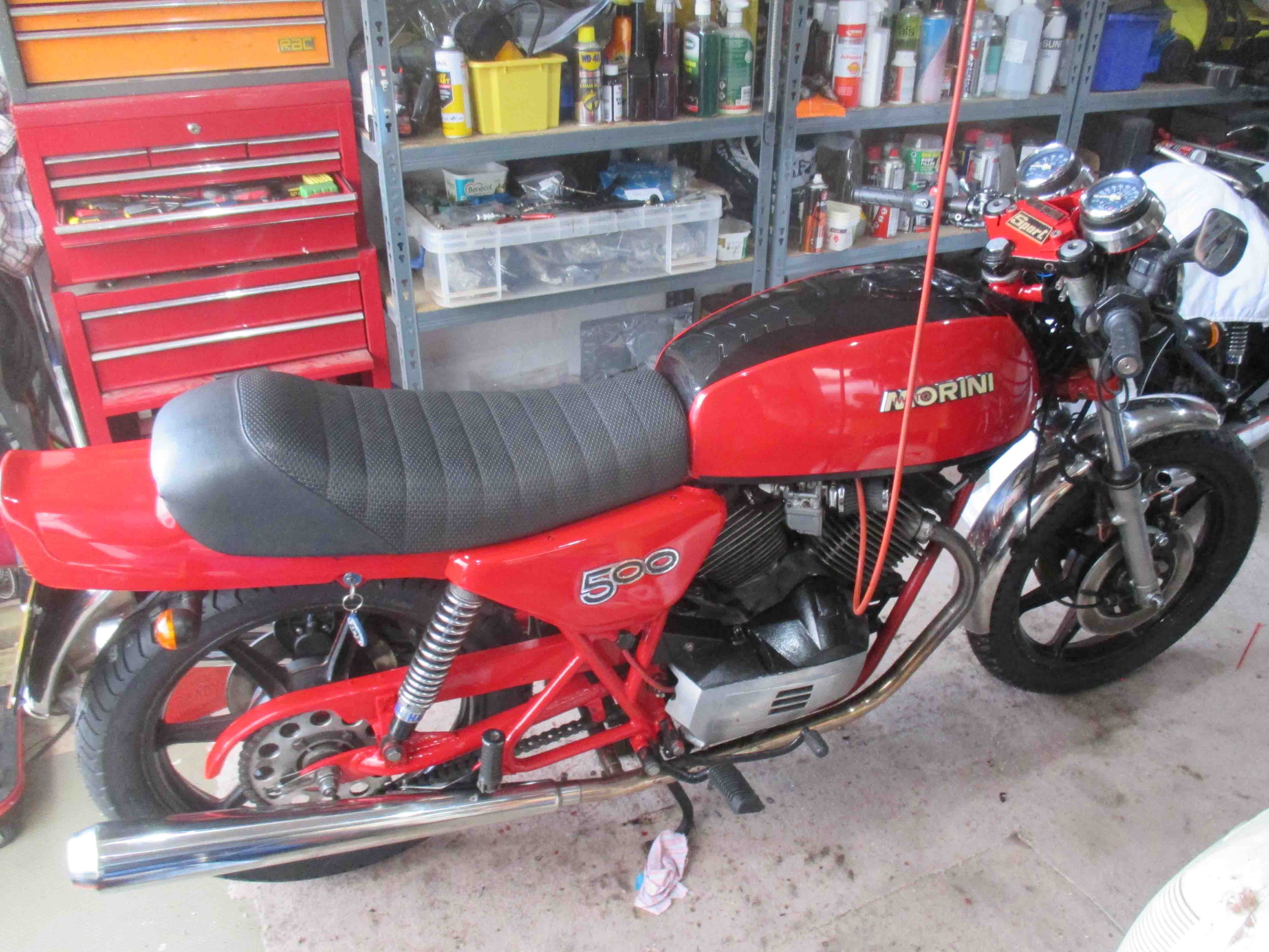

Hi. Well 99% finished. Just got to check the tank valves especially the electric one. I also need to plumb the carbs to the tank with clear fuel pipe. I have kept tank empty while checking fit on the frame and been using temp supply to the carbs for testing.
Engine runs and ticks over great. All the electrics work including the electric start.
Big thanks to all the people who answered all my technical queries on the forum. Its been a big learning curve.
I would like to thank Doug at mdina for all the parts and the chats. Great guy and company.
I think ive spent about £1500 recommisioning the bike for the road with ignition, tyres, brakes, electrics, battery, carb kits and choke parts etc
Im now waiting for some decent weather to do some local small shakedown runs before using during the summer.

- finished bike.jpg (397.67 KiB) Viewed 10728 times

Had my first ever ride on a moto morini today. Up till now its been a love of the look. Did my first shakedown run locally. At first couldnt get any gear above 1st. Stopped and ran through the gears stationary with engine off a few times. Started up and then got all the gears OK. Need to adjust the gear change lever to make up changes easier.
Ran it up through the gears and I have fallen in love! Its a beautiful bike to ride. Front brakes need to bed in and the rear brake needs a gentle application or you can lock the rear wheel. they all have new pads but the original discs. Handling feels good although I took it steady on the brand new bridgstone tyres in this cold weather.
I am really looking to riding it out this year.
