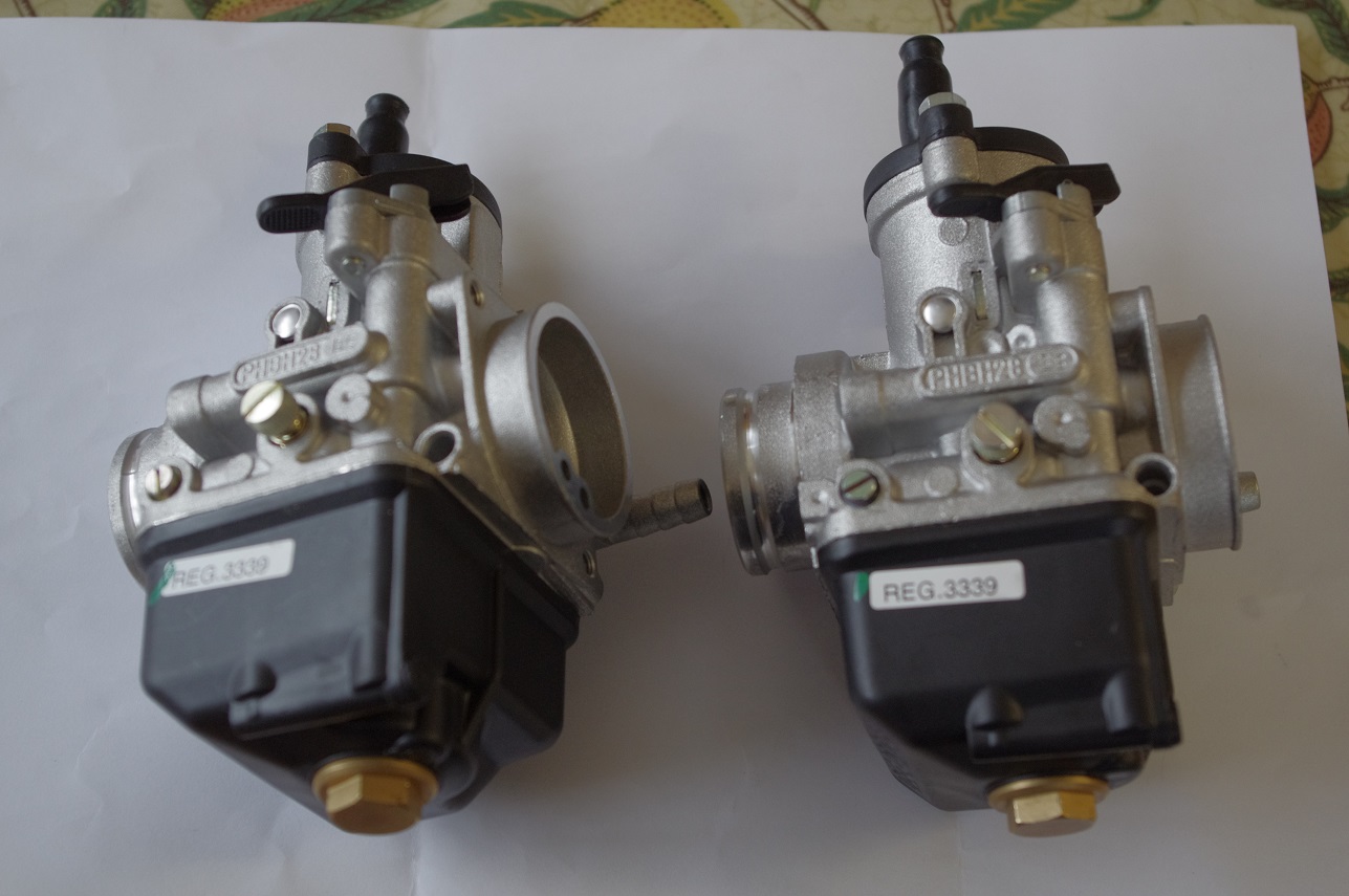

Not having much time to finish the project for Loton in April I had simply borrowed the PHBH 28s from the 375 and not touched the jetting. That has a mid-range flat spot that has to be ridden through sometimes. The project unit has a different (slightly less hot, it seems) cam. So it looks as if the only problem was wildly wrong half to full throttle carburation. Might still be ignition related (snuffing a weak spark at high revs) but it's running with the upgraded system from the 375 other than the pickup, which I can always do a substitution test on to eliminate. The stator seemingly doesn't provide enough volts to charge the battery, so it could also be a weird flux effext. Had that once before on SO Morinis but only when the lights are on and the lighting coils working hard. Doesn't seem to affect this one. The stator I am using is from the donor 250 bike, but the 375 machine has been converted to 12v (Reg/Rec and bulbs). I'll have a poke about with the multimeter tomorrow but the 250 uses the same stator as an early 350 I think so should be OK if in good condition? Like the clutch not really an issue for hill climbs though as long as the sparks department is up to snuff.
Anyway, the project is back on and so it will be getting spanking new PHBH28s that will need setting up from scratch anyway (better the devils you know will at least fit, are 'period' and available).

First start up with the new PHBH28s very encouraging. I'd checked the jetting on the current set on the 375, and in consultation with Eurocarb specified something that ought to be about right to begin with. Started easily and definitely needed one starter jet open - which is a good sign. Settled down to a impressively slow, steady idle when warmed up even without fiddling with the out of the box 1 1/2 turns out mixture screws and default throttle stop position. I've decided to clean the pod filters properly (first time for years) before bothering to get the Morgan carbtune manometer out. I'll need another set anyway and may go for tucking them up under the tank on the end of standard intake elbows (which I still have in the shed). The 125H tank might make that tricky for space, I realise, however, that I can address the cable routing issue when using that by use of appropriate angle elbow kits on the carb tops. It will need throttle cables anyway and I'll either use universal ones suitably adapted or get those nice people at Venhill to make a pair up with shorter outers (plus in cable adjusters while I'm at it).

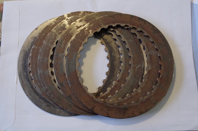

Clutch sorted. You can see from the photo that the plain plates were beyond a bit of TLC with abrasive sheet and a flat surface. I didn't bother getting new ones until I'd at least got it running reasonably by just fitting new friction plates. The centre/basket end float was still perfect and with all new plates and the new springs I'd already treated it to a brief 'creep' test on the drive was very encouraging. I did clean up the pressure plate though as that wasn't too bad.

Clutch much, much better. Not perfect but it will do. Possibly needs bedding in a bit, or perhaps the WeeVee special shims under the spring cups (came with the hex head spring nuts years ago) on the 375 make for the perfection I'm used to.
