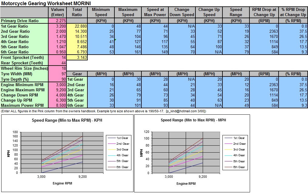

To be fair, revisiting my gearing Excel I've probably got plenty of rpm in hand in 6th even at Curborough. Even on the tuned YZ450F on near perfect gearing we could only just about hit 90 through the speed trap! Flat out in 4th is probably the best the 350 will manage.
- MORINI gearing.jpg (225.38 KiB) Viewed 22510 times
