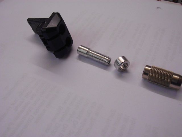

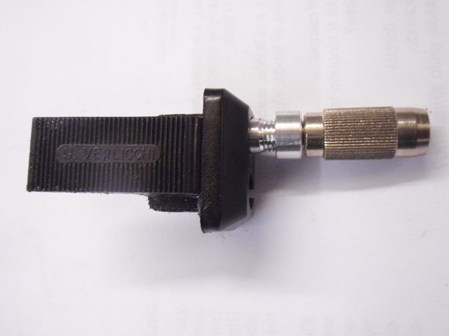

The cables for the 25 Dellortos do not fit with PHBH 28. You need more clearance. I make the carbcables myself using a standard inner cable with the nipple for the slides already fitted, and for the grip I take the oldschool small ajustable nipples. Never lost one :wink:

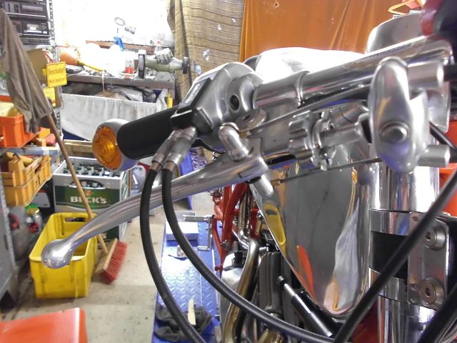

If you have the posibility and time and the fingers you need for it :wink: you can try to resolve the problem of the awful adjusting of the cables on top of the caburaters like this:

The replacement Tommaselli Quick Action twistgrip for the project comes with cable adjusters anyway, but I may see if the packet of odds and ends that is included with Venhill universal throttle cables allows for a similar dodge on the 2C/375.

Well the tip about solderless throttle cable nipples was very useful. The Tomaselli QA twistgrip is finally on. Note to anyone else going for one - it needs very different nipples to a Verlicchi item. I had to get inventive with the 6mm solderless ones I had acquired for the job but it's on.
