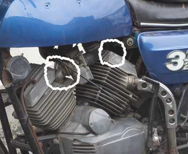

How to recognise those early strada's ? (Thanks to Werner from the German Morini-scene, he discribed it in the last Strega's)
Notice the full allu inlets and other valvecovers
Gearlever is steel and no grip on the frame
Bigger hole on the clutch side, previuos owner filled it up :shock:
No ABC size on the beltpully
