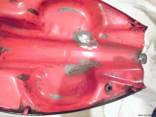

Re: tank problem
Hi Duncan,
I´m not sure if I understood well the location of the cracks. I have had several times very fine cracks underneath the tank on both sides at the rear part of the round dent for the filterbox. I believe its a sort of fatigue crack because of many many miles with vibrations (and in my case a 40l Harro-bag on the tank). Two times it happens when travelling and I could solve the problem for some month with a UHU 300 Plus two component glue. Later they were welded. Last year it began to leak again, allways in the same area. My last try is a superglue (works under water and all that stuff). It´s not oficialy gasoline resistent but a friend told me taht he used it at the same place years ago and since then no problems. Well mine since half a year is dry. This glue comes in cartidges like silicon and is called "TECHNOLIT Multibond"
Re: tank problem
Those look very much like my cracks - same place but not quite as developed as yours - thanks - Duncan
