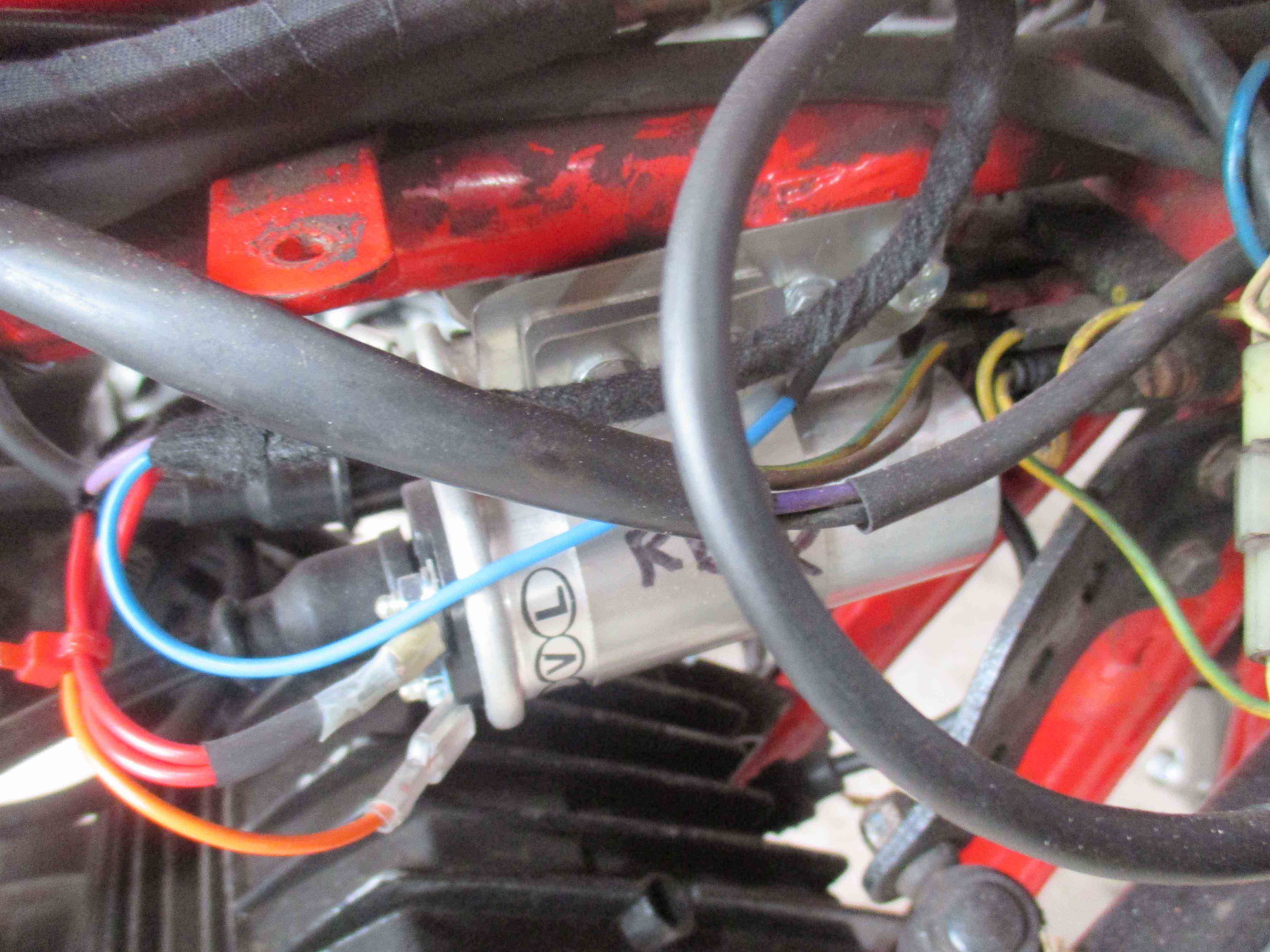

new coils fitted

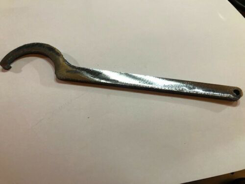

Hi bought this 50mm throat c spanner. Ground it down to be a bit thinner and it is great on the castellated exhaust nuts to the heads. £5.48. Bargain

I'm all for a bargain but I think you've missed a trick on the exhaust spanner. The ones made and sold via the forum are way better than any ordinary C spanner. They grip several castellations rather than just one and do not lift, slip or round off.

That is true!
But on the other hand such a solid one doesn´t hurt the crowns that much. I´ve used one of this for decades.
Anyhow there is a way to improve the tool (this one and probably the new ones as well):
Instead of the bore to hang it on a nail you can modify the grip end of the tool with a file or flex to convert it into a tool for the slut nuts of the clutch. A nice improvement to carry it with you when travelling :wink:
Great idea. When travelling it's best if every tool has multiple purpose.
The other end of mine (an MZ spanner) is a tyre lever.

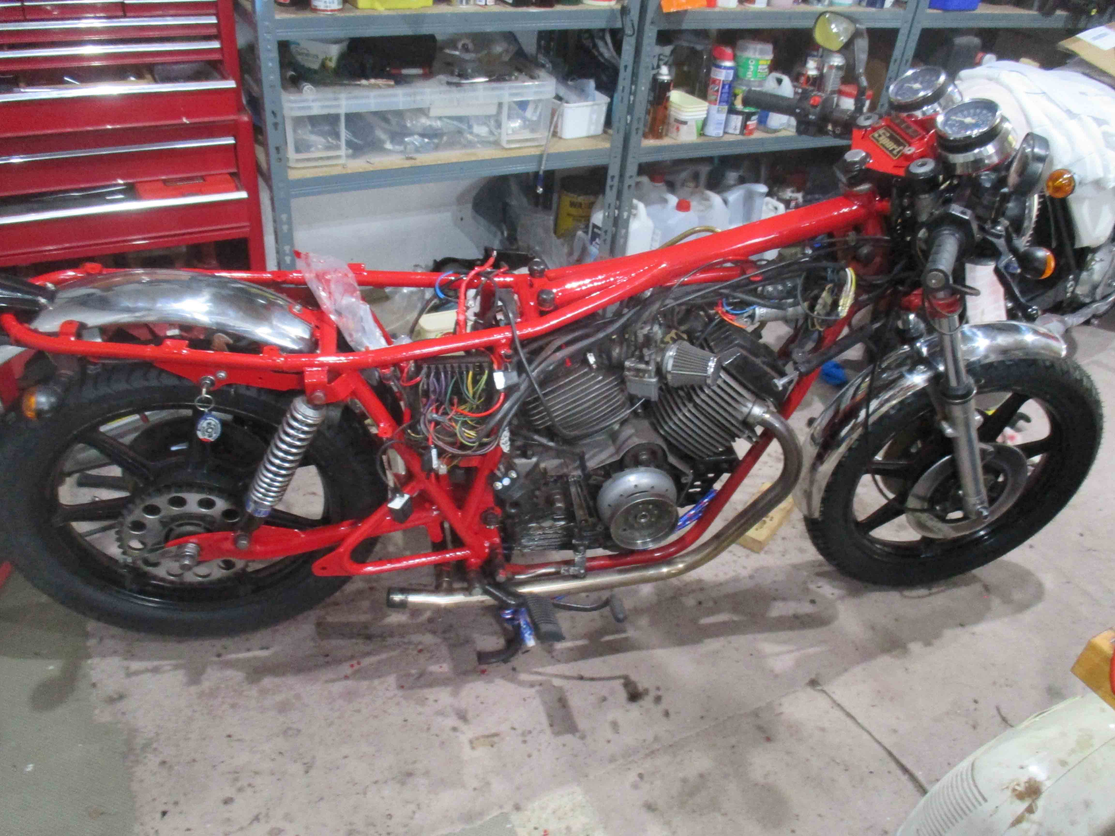

Post by bigred »
At last some progress. Rewiring done with new left hand switchgear off yamaha ATV. Old rear mudguard was split and rusted so fitted a secondhand stainless one from mdinia along with a new front one to match same supplier. Unfortunately all the brake calipers are seized up and need rebuilding. The copper hard brake pipes are also seized into the calipers and I have had to drill out. Waiting for a 10mm x 1mm tap and pipe making kit to turn up. Front caliper seal kit available for mdinia but not rear. Rear caliper luckily is the best of the three and rubbers look good. Fitted new BT46 tyres. 100/90 front and 110/90 rear.

Very interested in the Yamaha atv switch on the LHS!! Was it one you had laying about or sourced specifically?

Nice to see you are getting stuck in. With regard to LEDs, I have a LED tail light, courtesy of Paul Goff. I also put red led instrument backlights in, just to be a bit of a smart arsre. I found that coloured LED mini wedges for the idiot lights were actually too bright, being dazzling for night riding. The most useful would be the “Turn” indicator light but that is a bit more involved due to the polarity of the led and I could not be bothered. I have a concave Cibie headlight, beloved of the Yamaha fraternity with a rather old VisionPlus bulb. Seems to work. I avoid night riding nowadays due to four legged stuff and potholes.
The starter motor will, like me, respond to a good strip and clean.
