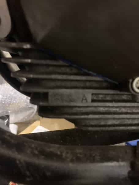

Nothing adds up. If it has a K frame then it should have electric start. The engine casing suggests otherwise. The K had more rear set pegs with a linkage to the gear lever.
Does it actually have a generator (2 yellow wires)? If it was a racer it might just have a magneto coil for the ignition under the rotor.
Rear mudguard does not look standard nor the alloy wheels.
On the left hand side of the engine low down there should be an engine identifier.

Well chaps I’ll go look for the engine identifier. The alternator still has generator wires in the lead & their resistances are kind of what I’d expect to see.
As for the rolling chassis, I’m sticking on what I’ve got lying about spare. I don’t see any value in hunting for original parts for this machine, it’s too far modified to be worth it. I’d just rather get it to riding condition & enjoy it. I’m not that bothered with the mechanicals of the engine as long as they work. I’ll cross any identifier’s there as I need to unless there’s some easy visual stuff you guys can suggest. The carbs I’ll sort no probs but I’ll need to sort the cables better. I’ll fabricate stuff, including a wiring loom to suit the power requirement's of the lights I’ll put on.

Is this the engine identifier??
