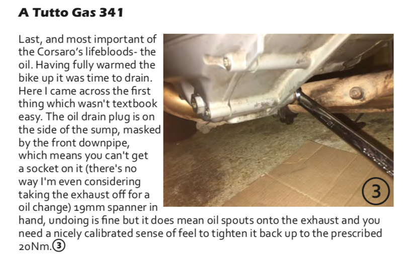

yes, you are right and apologies for the bum steer... I just went and had a look at mine and no, I obviously don't use a crows foot.
So I took a look at ATG 341 (April 2016), in which I wrote an article on fluid change on my corsaro, and this confirms I use a slim 12 point ring spanner and a careful feel for tightness. You can get slim ring adaptors for torque wrenches so one of these could be an option.
- ATG 341.png (349.81 KiB) Viewed 9572 times
