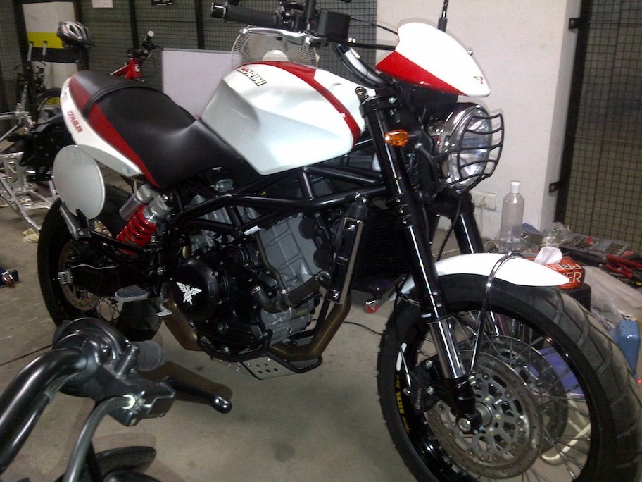

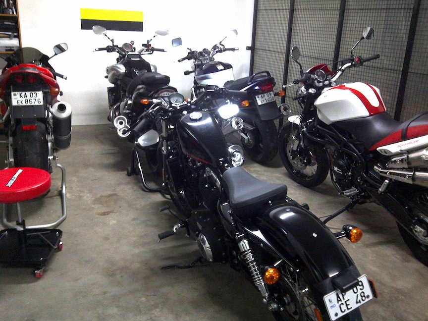

Here are the pics of her in its new home. Just towers over everything in the garage incl the mighty VMAX. Well, I guess its the way Italians do things, simply brilliant and beautiful.

Wish my garage was like that!

Nice Garage!
