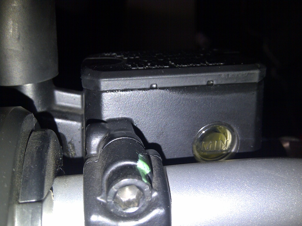

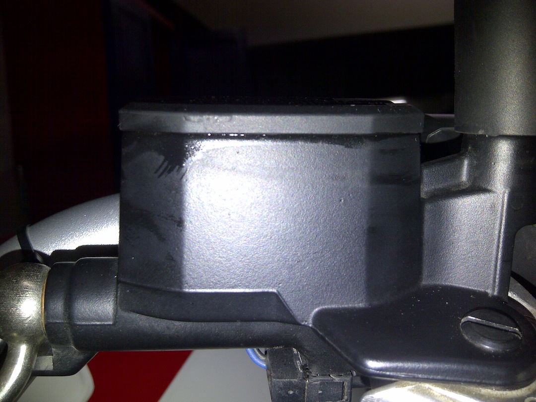

Guys, took the Scrambler out for a short spin around town and riding temp was between 93-99 Deg cel. After reaching home i notice that there are multiple leaks from the clutch Master cylinder. The cylinder was neither hot nor the cable overheated, all normal. Too early for the rubber gasket to give up. Could it be over filled in the first place? Both the clutch and brake master cylinders are filled above the viewing pane level, don't see oil move up and down. Here are the pics! Please advise.

It's possible that it's been overfilled and the level is just settling. I would remove a small amount of fluid and keep an eye that the level does not go too low or that it does not continue to weep.

Thanks everyone for the advise. I took her out again for registration inspection and it was very hot, really hot i mean. The reservoir didn't weep and no other issues. Will take her out on a long ride and if she weeps again, i will reduce the brake fluid.
