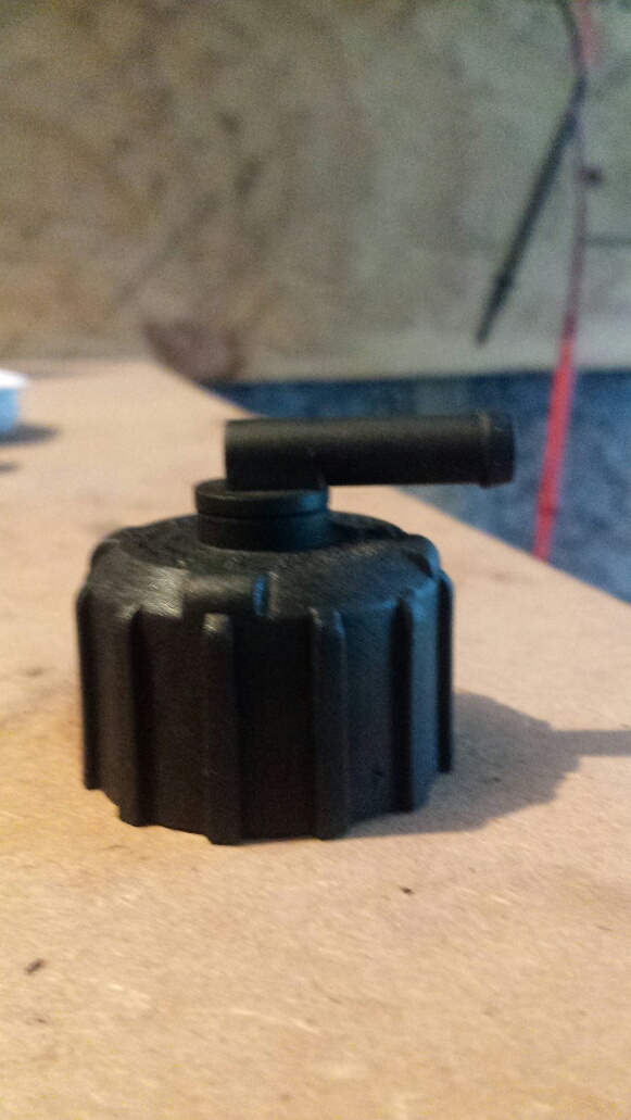

Hello I have a (silly) question about my radiator cap. If i understand correctly it has a one way valve that opens at 1.0 bar of pressure. What's the purpose of having coolant in the overflow bottle?
The bike seems to be overheating far quicker now and even the fans struggle to keep the temp down. I think the coolant is old (2 years..? I know sorry) what's the easiest waay to replace it and can i use any budget coolant or should i follow the booklet and find the Bardhal special one one mentioned on it
Also I have misplaced my bottle cap and finding really hard to find a spare one unless i go via NLM and wait 2/3 weeks. Can anyone point me towards a compatible one on the internet without it being the whole set which I have managed to find?

Radiator and Overflow caps scrambler 1200
- 20160628_192653_resized_1.jpg (183.23 KiB) Viewed 23586 times

Re: Radiator and Overflow caps scrambler 1200
One valve opens at 1 bar allowing coolant to escape to the bottle
but there is another anti vacuum valve that lets the coolant flow
back as the engine cools down.
Thanks Ralph I've just bought a Scrambler and I think the anti-vacuum valve is failing and lets coolant back into the header tank even though cooling system pressure doesn't come up high enough for this to happen. Do these radiator caps fail often and if I can't fix it, are they a standard part on other bikes?Ralph wrote:One valve opens at 1 bar allowing coolant to escape to the bottle
I had a cap fail on my 2008 corsaro. I assume all the water cooled Morini use the same cap-
It’s a standard part, easily available. I fitted an identical cap from a KTM On the advice from this forum and it’s been perfect since.
KTM 1.0 bar Radiator Cap LC50, 2001- KTM part number 45135009000
For info the morini club compiled a list of alternative parts Suppliers when the factory looked like it was closing down for good. The list may need updating now (let me know if anybody has anything to add or edit) but can be found at the below link:
http://www.morini-riders-club.com/thebikes/parts.html
