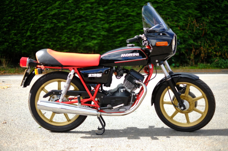

This is my bike,
Jan

That looks soooo nice!

What a pretty little machine 8)

Lovely. Shiny, shiny! I don't think the 125H tank I'm going to be giving its final coat of Hammerite smooth red just now will look quite as good even from a distance.

Love that fairing!

Lovely looking bike, by the way!
