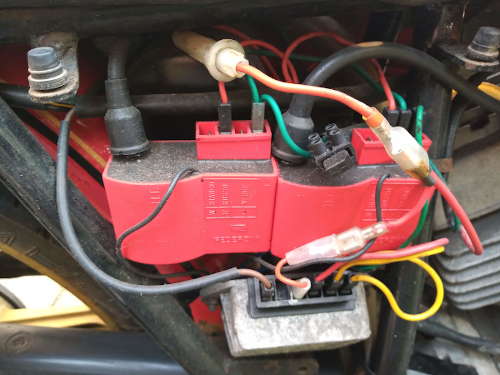

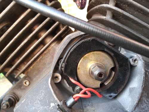

These are the photo's I sent to Alex.
Until I looked at the potos, I'd not really nticed the chock block is actualy holding a componant, rahter than just joining wires. It's not got any markings, but I suspect it's a diode, which would make sense from what you say. I'm not sure why there's only one, unless the other one is hidden behind the transducer. The bike is 1980, so if you say the diode was remived from the pick up in 1983, I guess this is a later pickup that's been fitted.
I'll have a good look over the rest of the loom when I get the transducers and go through the earths.. There's obviously been some modification to the wiring around the transducers, but mercifully, the rest of the bike is in original condition. My only other issue is the seat. It seems to have lost it's hump and I suspect someone cut it off to fit the rather nasty universal seat cover. I got excited when I saw Mdina had the cover listed, until I saw it was out of stock.

Its hard to be sure, but that does look like a genuine black pickup.
The device in the choc block is another diode, this is in the green lead to the switch and is used to prevent a fault in the switch from getting 12V onto the ignition circuit, if 12V gets onto the green wire it kills the transducers if you try to start the bike. It is shown in the wiring diagram
PM me and I can email you the user manual.
