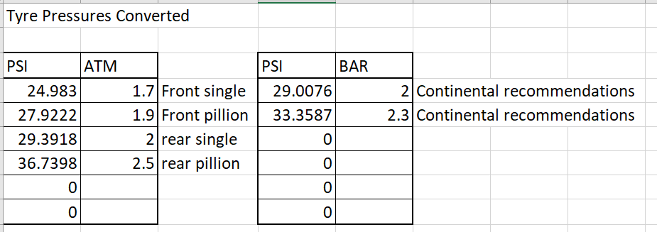

Just returned from a week away and thought I would measure my tyre pressures.
Rear; 26ish psi
Front 20ish psi
I think I checked them a couple of rides ago. Maybe just over a month ago.
So my conclusions are:
1) Check tyre pressures every ride!
2)Run at with pillion pressures (rear maybe up to 38psi) See picture of chart I made to convert from ATM and BAR to psi. 3) Don't use ContiGo tyres again!! Easy as they will not be making them, but current tyres will probably outlast me given the annual mileage I am likely to do.
Rear; 26ish psi
Front 20ish psi

Barry, many thanks for your thoughts and measurements .My forks have the same dimensions as yours. My shocks are 320mm, I am not sure 10mm will make that much difference. The forks and shocks have 5w oil in them. I think the forks are softish, but feel that is spring rate not damping.
In the meantime I checked my rear pressure again today and it was down to 33psi, from 39psi on Saturday. I found I could tighten the valve body quite a bit so am now wondering if I have had a slight leak through the valve, leading to lower pressure. The wobbly feeling is more rear tyre low pressure than fork angle being wrong.
I am in Brentwood, so not far from Cambridge. It would be nice to meet up sometime and compare notes

Mark, thanks for all of the useful info. I may try 10w oil. I have bought some forks from Arthur, so I can see if I can get mine better! The damper rods are very corroded and one of the forks still has a little more play than I would ideally like. I can measure my springs and compare.
Occam's razor? The simplest things...
So:
1) As mentioned I have tightened up the valve in the valve body and the tyre maintains pressure for at least a week, not sure it was before.
2) I feel so stupid, I checked the pressures with a different gauge and found my, new this year, tyre pump gauge is overeading. So 30psi on the gauge is nearer 20psi on other gauges.
Ran at 28psi front and 38psi rear today for a fair run at different speeds and felt a lot better. The 'a bit weavy' seems to be gone, at last!
So:

Don't feel stupid - it took me a while to realise my beautiful and expensive new pump was reading 10psi low.
- Posts: 2730
Re: Tyre pressures?
I was once told there should be a 3 to 4 psi difference front to back. Not sure if anybody has a clue about it?Parker3865 wrote: ↑12 Sep 2024 14:42 Mark, thanks for all of the useful info. I may try 10w oil. I have bought some forks from Arthur, so I can see if I can get mine better! The damper rods are very corroded and one of the forks still has a little more play than I would ideally like. I can measure my springs and compare.
So:
I use 32/36 on my 350, but then how do I know my gauge is correct?
