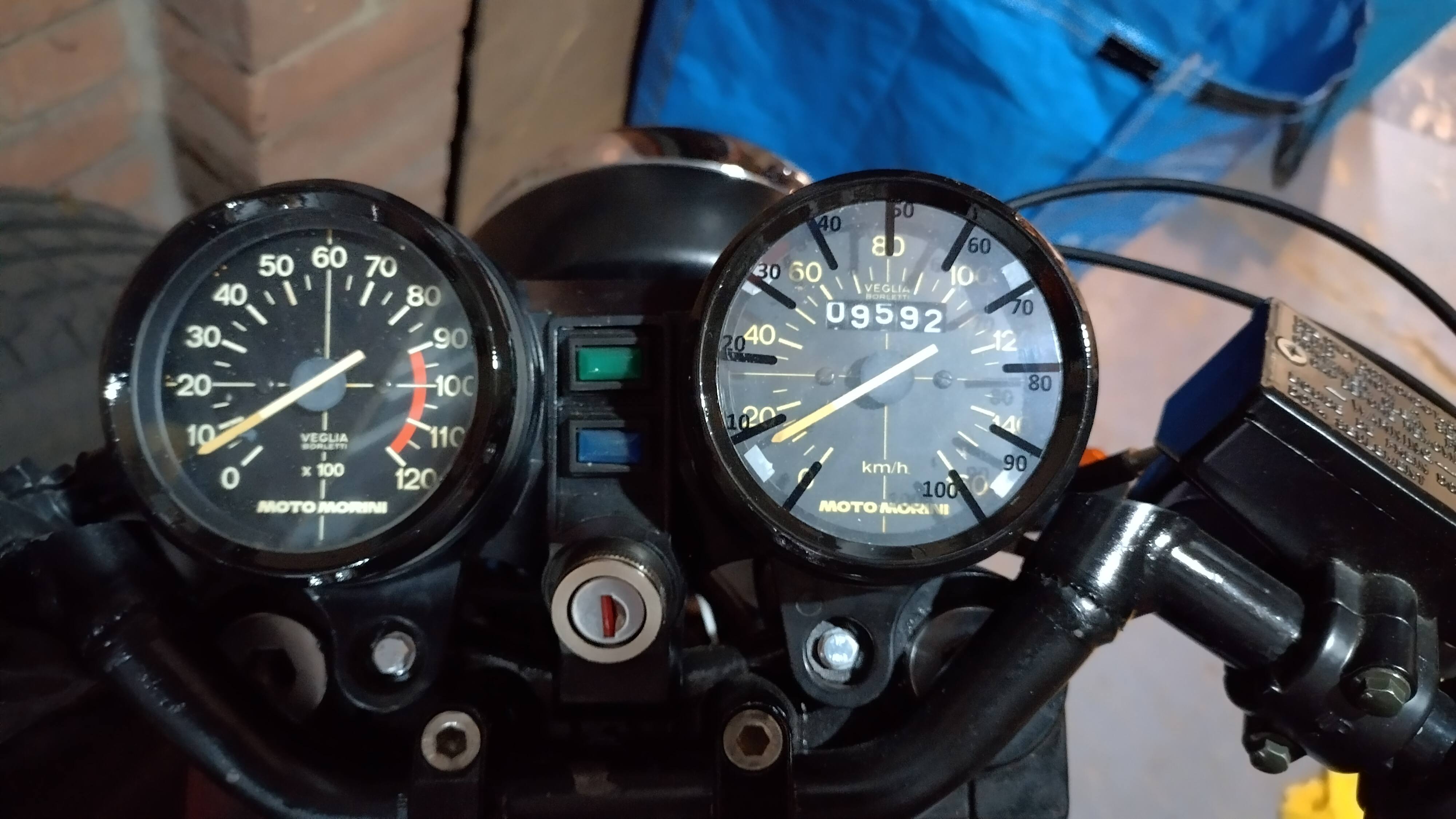

Decided to put marks on the speedo. So did a bit of maths to scale the mph to kmh and printed in some inkjet OHP film (printed reversed so the print is behind the film). Just annoyed I couldn't get bright colours to show up so ended up with it just in black.

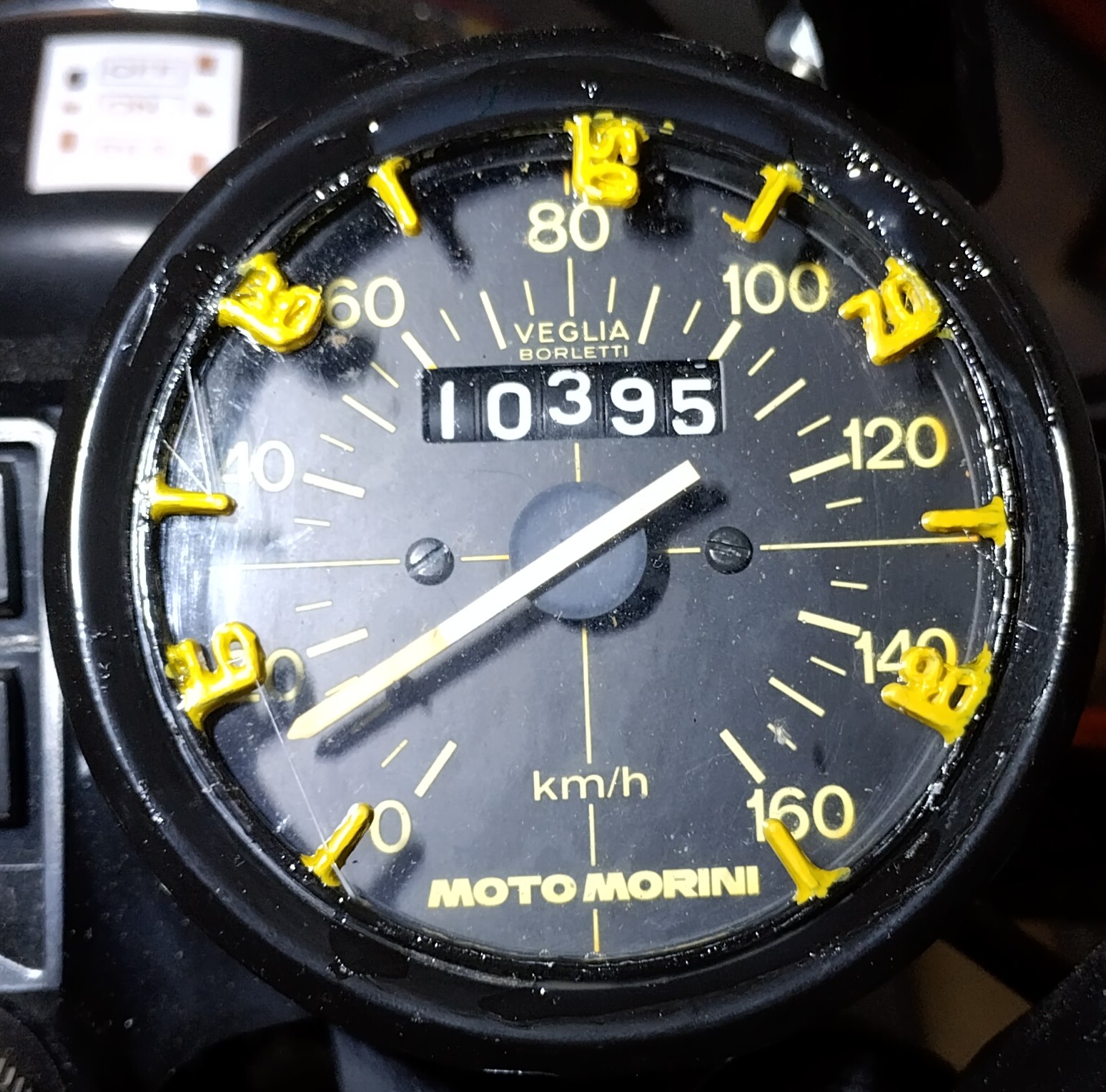

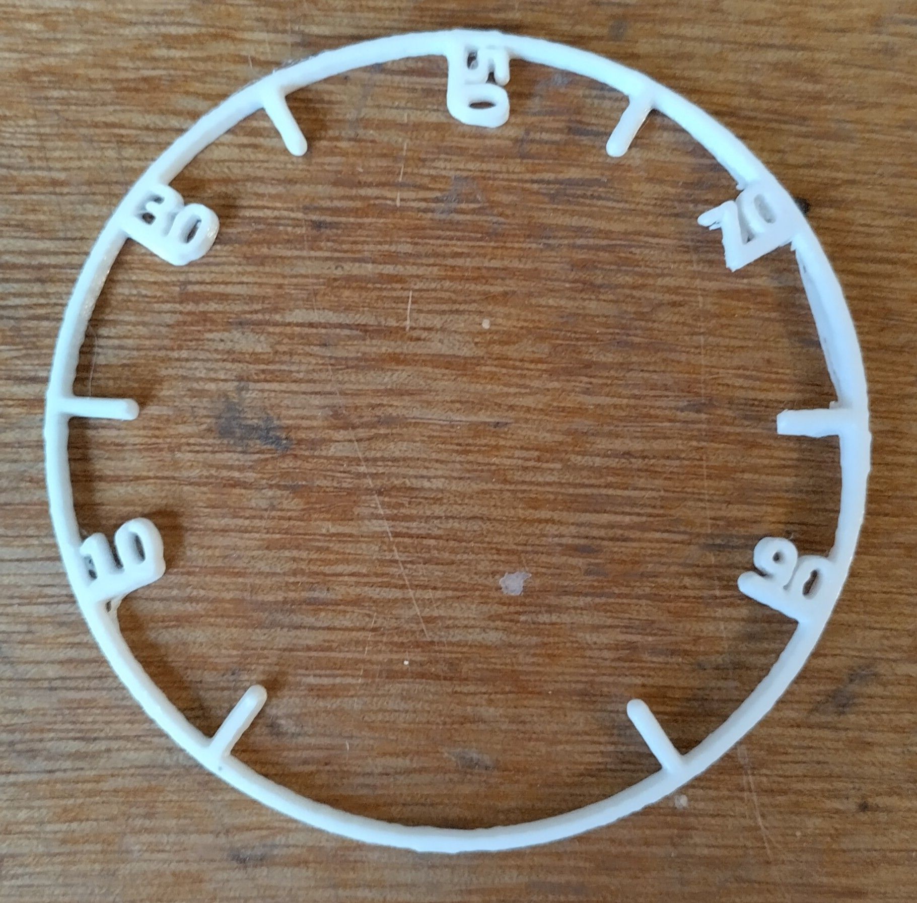

So the OHP print succumbed to the rain, the printing blurred and the film started to degrade. After a rethink I have produced a 3D printed version.

and then painted and lacquered.
20241113_speedo dial.jpg (458.68 KiB) Viewed 7398 times
Not sure if I need to fiddle with the font and size of the numbers. Hopefully a better solution.
