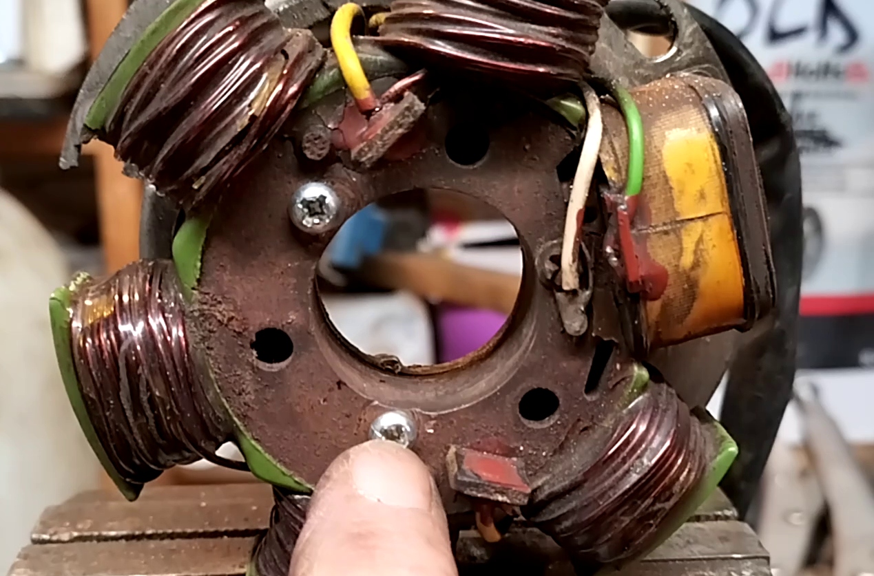

So I started my bike after an oil change and not having run it for a few weeks. I was greeted by a squeaking/graunchy noise at low revs coming from the alternator cover. So off with the cover, off with the flywheel and wriggle the stator coils. Oh dear there seems to be some play! So off with the stator and it seems the long rivets that hold the coil laminations to the aluminium stator plate are ever so slightly loose. Must be enough to rattle/rub against the flywheel, although I could see no witness marks. So bodge a rivet stake to place them against and thwack them with a hammer and punch. Now tightened up, re-assembled and quiet again. Any guesses how long this repair will last OR will i be needing a new (to me) stator?

You can replace the rivets with new ones, or with screws - but if you use screws ensure that the heads / nuts don’t protrude enough to rub on the rotor. Also use loctite on the nuts. - this from personal experience.

So rivets loose again. Some axial play but not touchIng the flywheel (that I can see). I wonder if it is more crash damage?

The good news; I have drilled out 2 of the rivets, I have left the third with the solder joint as I did not want to disturb it. The 2 drilled out rivets are replaced with M4 machine screws, nylock nuts on the back (and a bit of Loctite for good measure). The laminations appear to be concentric with the backing plate and all seems secure.
The screw hole that seemed stripped has cleaned up with a tap and I made a longer screw to reach through to some good thread.
I think I have my stator 'repaired'
