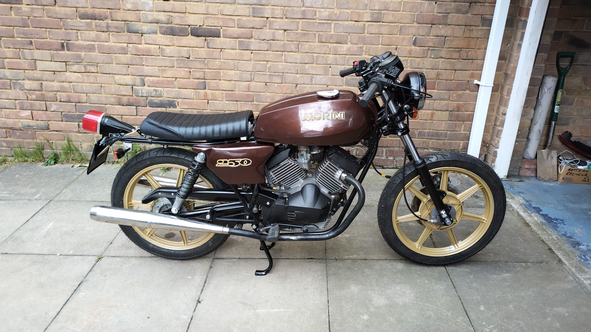

So finally almost all together. It runs and I have had a naughty ride in our cul-de-sac just into second gear. Temp seat while I decide if I am going to have a go at re-foaming and covering the seat myself or pay for someone else to do it. I am collecting the mudguards next week from my friend who has been doing the tinwork paint. A few more little jobs to finish, things to refurbish, all the things that take far more time than you realise. Now to start trying to get it registered.
- 20240417_155007 views outside.jpg (464.2 KiB) Viewed 11612 times
