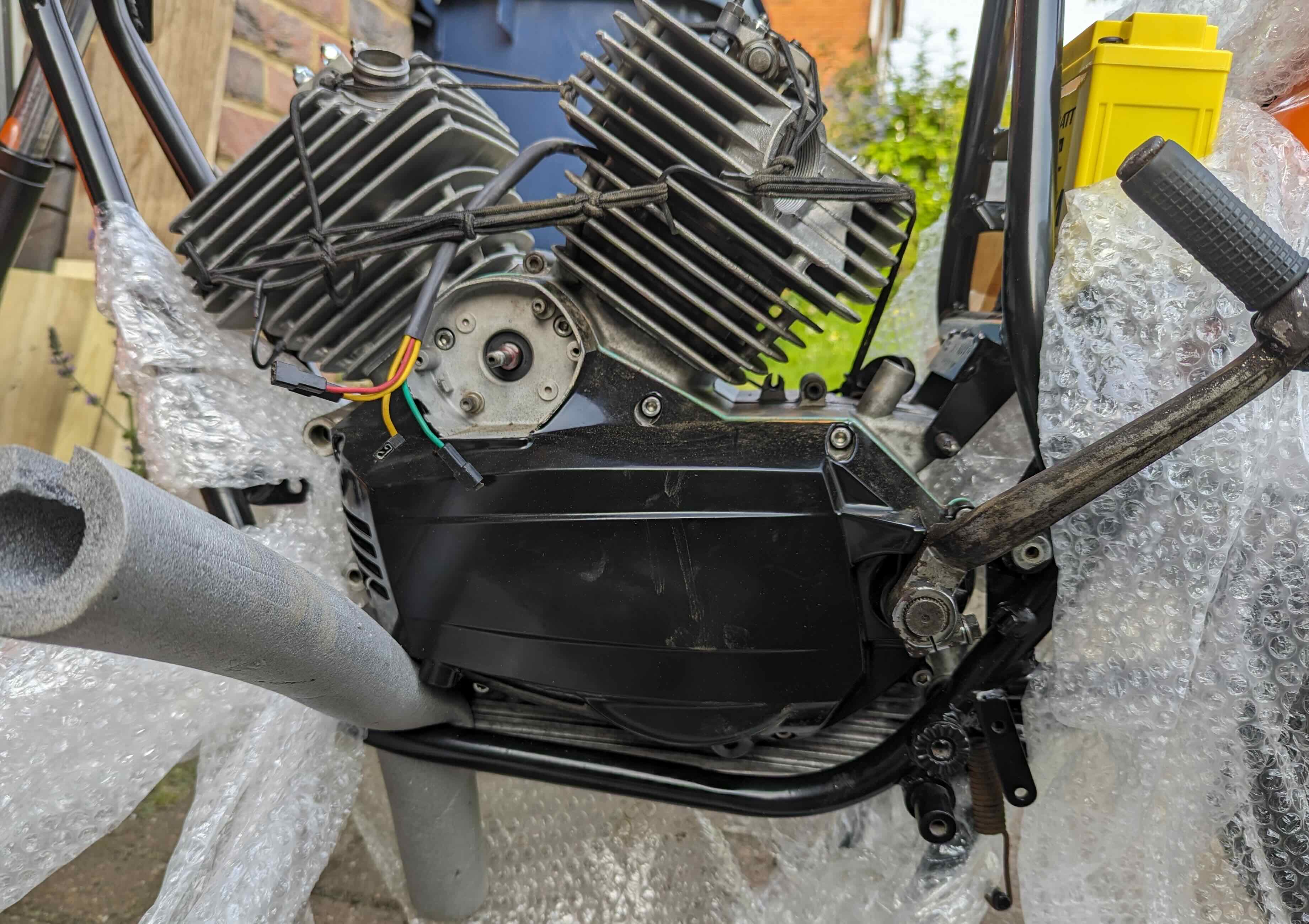

Detail:
Here's how I fitted the engine to the frame; the rockers were on and the spark plugs were in by this point (the tip of the rear plug is just about visible)
Fitting the 250 2C engine in the frame.jpg (489.49 KiB) Viewed 9285 times
I've separate photos and videos for when the engine ran initially and then after I'd fitted the airbox and balanced the carbs. The engine ran well with no hint of a washer rattling within.

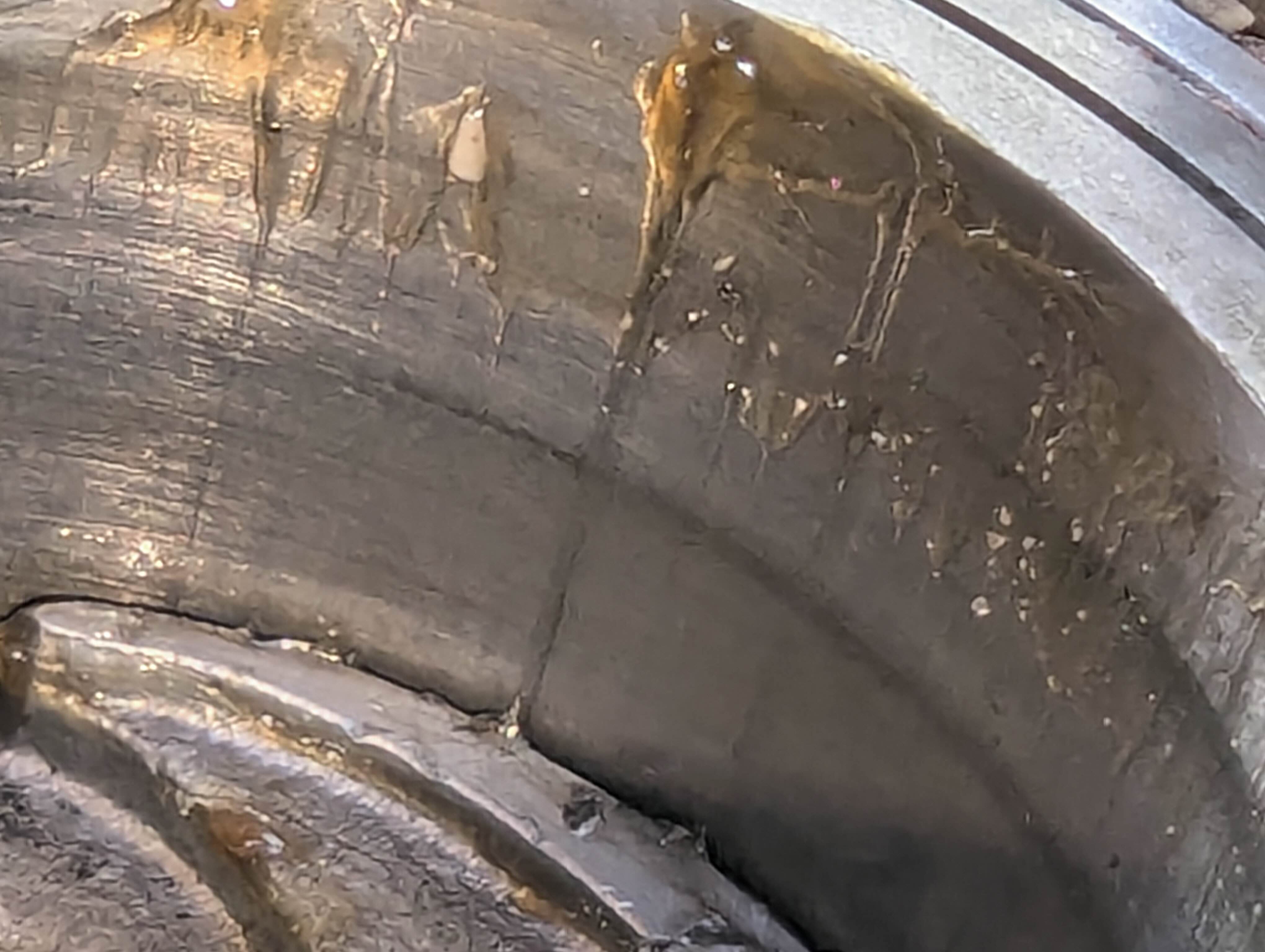

Your recommendation was spot on. I ended up using lithium grease in a layer around the circumference of the barrel and turned the engine over gently several times. The piston deposited various pieces of metal, some probably steel from the spark plug tip. I cleaned off the combined grease and swarf and repeated this several times until no new swarf emerged. I then removed the barrel carefully and with material to catch any more bits and pieces.
Then it was on to checking the piston rings and how cleanly they rotated in their respective groove. There was a grittiness so I've removed the rings and cleaned the grooves with a combination of a wooden toothpick, a fine interdental dental toothbrush, spray brake cleaner, etc.
swarf from the side of the piston.jpg (489.01 KiB) Viewed 9238 times
I've also honed the bore using a couple of inexpensive mechanisms. There's still evidence of vertical scoring however it's undetectable by my fingers and should be fine (I'll know more when I do a compression test).

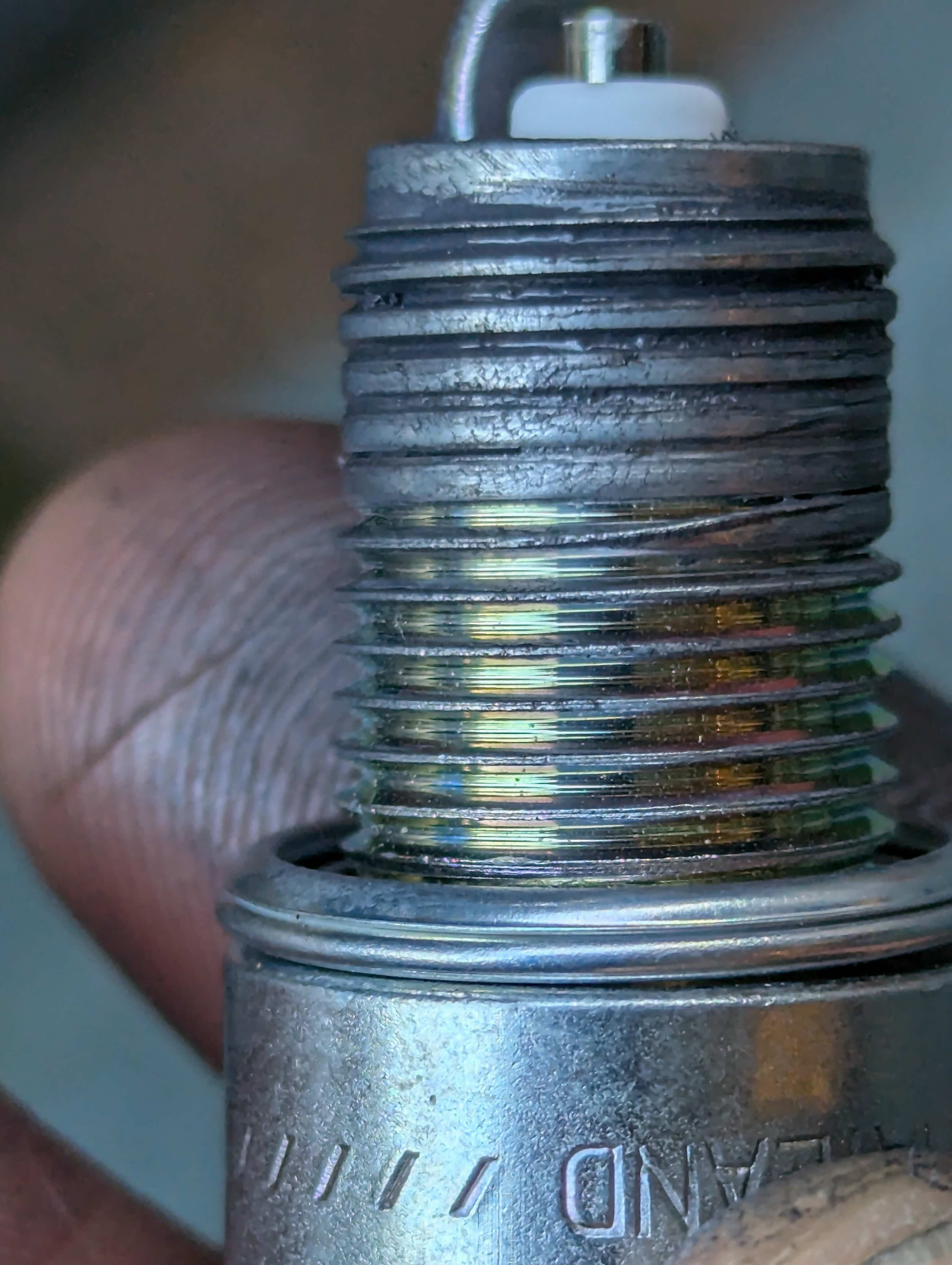

  • The super-duper helicoil kit worked (I might write this up separately).
  • ...But the resulting thread was tight and damaged the thread of a brand new NGK spark plug. I used the Sealey thread restorer tool (Sealey Ms003 Reverse Action Spark Plug Thread Chaser) to good effect, and fitted another brand new spark plug - still quite tight but it'll do until I've reason to investigate again.
