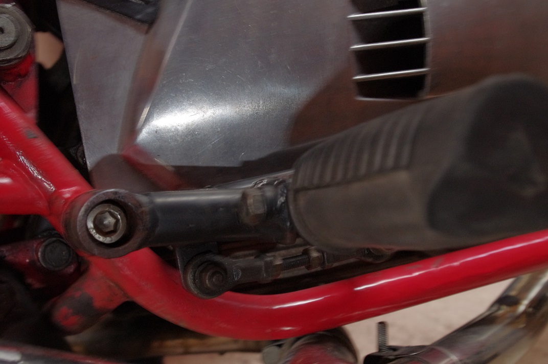

The foot rest I find are a little too high - my knees are level with the top of the tank - which make me feel as though I am "perched 0n" rather than sat on the machine. The rest themselves are fixed to the frame via a serrated ring. it would seem that slackening them off, turning them rotund one notch would be the answer, but no. However with the gear change linkage fixed to the foot rest arm itself and any attempt to turn it round it then hits the exhaust pipe. On the other side the rest hits something else, so I need to think of some other way.
The photo shows the problem. I could just make up some extensions to drop the rest down from the pivots but that seems a bit crude, better ideas anyone?

Can't think what it is fouling on the brake side,
If you look at the photo you will see a small plate projecting downwards, at the right hand end of the the plate that carries the peddle adjusting screw. Its not clear from the photo but there is a gap between it and the brake peddle arm pivot, However it's not a big enough gap to allow the rest to be turned even one notch before it fouls. Could grind a bit off I suppose, but why is it there in the first place? Other that to stop people like me from lowering the rest?

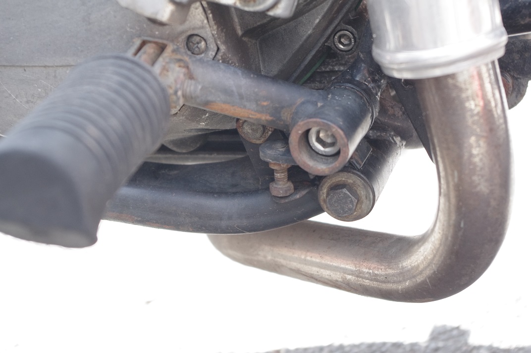

My two 250s are far from standard. Both have 350 engines with 2:1 exhausts. If I remember correctly the 250 2:2 system is much tighter to the crankcases.
Neither have canister brake light switches (none on the 'racer' obviously and a clamp on generic type on the road bike.
For what help they may be here are three shots (not of the road bike brake setup as that is hanging off while clutch work is underway).

Thank you 72degres , the photos proved very useful. The first thing I noticed was that your foot rest were more or less flat i.e. parallel to the ground. If yours could be, why couldn’t mine? As acquired the gear linkage was fitted on the inside, that is towards the crank case, when the foot rest was rotated the linkage hit the lower frame rail. Moving it to the outside cured that, but it now hit the exhaust pipe instead. However by adjusting the brackets that held the (after market) silencers on I was able to move the pipe just sufficient both outward and down to give clearance. So for the offside, result.
For the nearside the problem was a small plate welded to the underside of the footrest arm that fouled the brake peddle pivot, or to be more precise the lobe or cam that operated the brake light switch. As I could not see any reason for it to be there (other than get in the way) I simply ground it off. Once out of the way it was a simple mater to rotate the arm to a lower position, adjust the peddle and cable to suit, job done. Well not quite, needed to reposition the brake light switch.

Oh yes, the pivot needs to fitted 'outboard'. I didn't notice yours wasn't.
When I first built the Forgotten Error I used a 250 2:2 system and made the mistake of putting it on before the gear lever and linkage. I
I'm glad you got it sorted out. I love the adjustable 'ace type ' bars on the road bike but once again they can't be adjusted much at the pivoting ends, though naturally you can turn the bars in the clamps.
