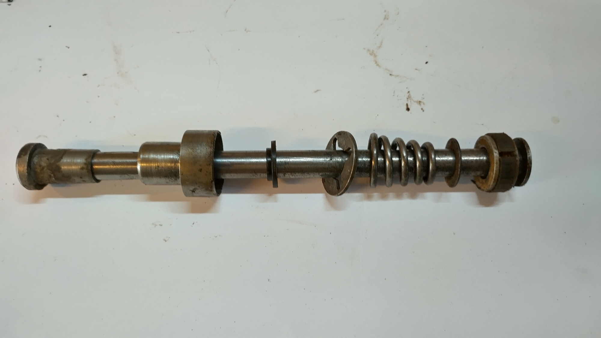

Looking at the parts book and my video of taking the forks apart and I think this is the damper rod assembly:
If you know different, please let me know.

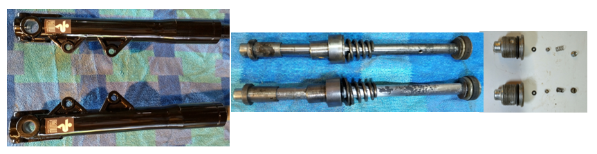

Finally back together. Best of 2 sets of fork legs used, hopefully I have the internals assembled correctly.
exploded fork assembly.PNG (368.49 KiB) Viewed 9061 times
