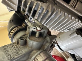

AND ANOTHER SOLUTION !
attachment=0]IMG_8996 x.jpg[/attachment]
I assume these will fit but need longer screws. These are Dellorto model 8796 6mm outlets and they are in stock at Eurocarb...used on the 250 T Morini single..you can see one on my sectioned engine which will be at the Morini Rally this coming weekend
Angles not really satisfactory but another solution!!
- IMG_8996 x.jpg (23.02 KiB) Viewed 10420 times

- Posts: 1671
Re: Petrol pipe bore for the 250 2C to suit the fuel taps and carb inlets
Arthur, I'm pretty sure that Dellorto list those bolts in 2 lengths for the different banjos. I've found oddities on some bikes too.
