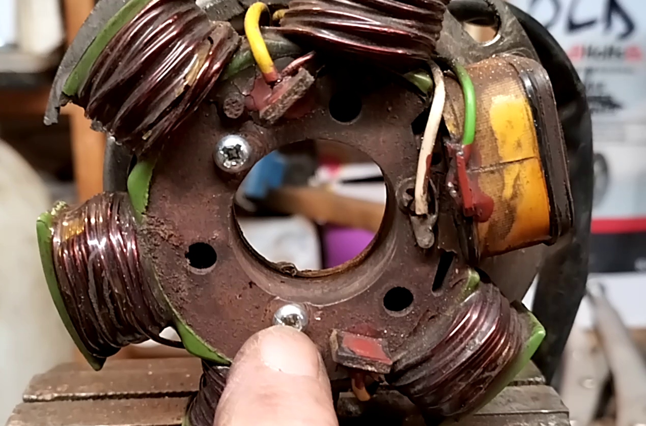

The good news; I have drilled out 2 of the rivets, I have left the third with the solder joint as I did not want to disturb it. The 2 drilled out rivets are replaced with M4 machine screws, nylock nuts on the back (and a bit of Loctite for good measure). The laminations appear to be concentric with the backing plate and all seems secure.
- 20251128 stator rivets replaced with screws.jpg (409.33 KiB) Viewed 545 times
The screw hole that seemed stripped has cleaned up with a tap and I made a longer screw to reach through to some good thread.
I think I have my stator 'repaired'

Just caught up with this post. t does look like your ignition coil is kaput. It will be worth getting it rewound for sure. The stator you have looks like one of the high output late model versions.
I mentioned earlier that I had a similar challenge with a loose stator. I've just refitted the thing today! The same three rivets on mine had failed, I hopefully have fixed it with 3 roll pins to align things and 3 x 5mm screws. The holes were enlarged as it had been run while the rivets were loose, so I drilled them to 5mm (after the roll pins were in place in the smaller holes) I had to grind the heads of the screws to allow them to sit right. They are clear of the rotor and it is now charging like a good 'un. I have a generic rec/reg fitted and am hoping it can handle the extra charge current. At least I should be able to use my heated grips and gloves now, in theory! Road testing tonight with lights!
