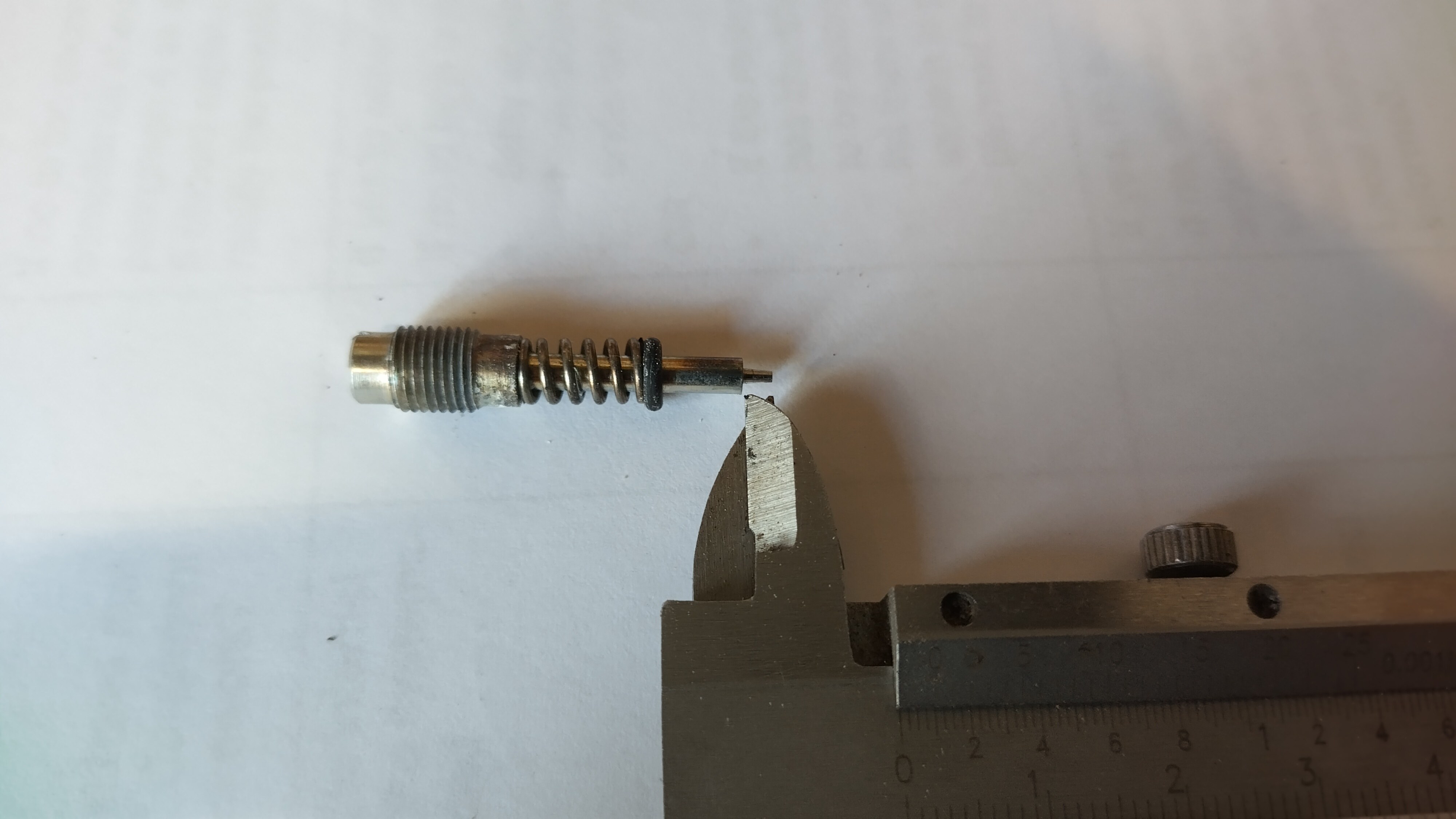

I have done about 800 miles on my rebuilt 250 2c. I had noticed that it was very fluffy at part throttle (if it was a 2 stroke I'd say it was 4 stroking) and a stutter when opening tbe throttle. I have dropped the slide needle one notch and it is running much much better.
However! When adjusting the idle screw at tickover any more than 1/4 out makes no more difference. I believe I have the standard idle jets; 40. I have the shorter mixture screws and have read Mark's article in ATG 222 (thanks to Julian for that) and I assume it should be more like 1 1/2 turns out. F.Y.I. I have the blue scooter transducers and I think I have the timing correct. Currently using superunleaded.
FINALLY: the question I have read elsewhere on the forum that people have jetted down the idle jet; what size might be suitable?

- Idle needle
- IMG_20250326_144939.jpg (471.27 KiB) Viewed 7019 times

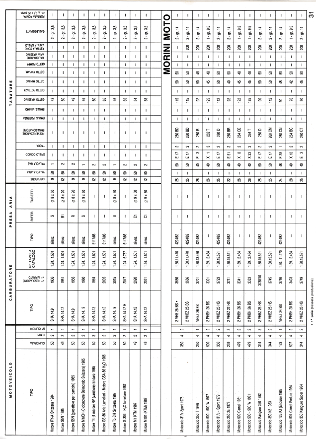

As yours is already a small-ish 40 I'd say not much less! 35 for instance would be a big % difference. Before you try that consider that the needle adjustment has been fruitfull and that maybe the slide cutaway is worth adjusting? A few of us have found raising the cutaway has helped a lot, as little as 0.5mm at a time. I'd also say check the fuel level first, the float position is easier to do but still doesn't tell you the actual fuel level. There are Dellorto docs somewhere that tell you how high it should be, something like 5mm below the float bowl joint face.

Both the table on the archived Netherlands site and one sent to me by Euro Carbs say 40 jet size. Mine was fitted with 42 for some reason, before I got it. The problem is with anything this age is previous owners could have fiddled with jet/slide/needle sizes trying to correct ignition problems!
https://www.morini-riders-club.com/Nederland/carb.html
Half the older cars or bikes I come into contact with seem to have been 'fiddled' with, so I like to go back to standard and start from there. Bitter experience tells me, don't assume anything!. Just because it says Dellorto on the side, doesn't mean they started life on a Morini and not a Guzzi. On two occasions I've found carbs off completely different things. On one occasion a Dellorto on a Ford Zephyr which while the correct model (but wrong choke size) turned out to be off an Royal Navy generator, as the previous owner was told it would improve the fuel consumption!

Thanks Barry. I put new jets and needles in the carbs when I rebuilt the bike and used the NL website as reference for what I needed. I will check the ignition timing again.

Re: Part throttle jetting
I have done a few runs now and it seems to be running fine. Idle mixture screws about 1/4 turn out and needle dropped one notch. It happily ran to the Ace Cafe and back. So I think I am going to leave it alone now.
