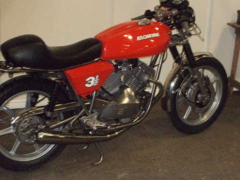

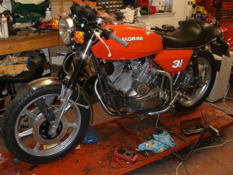

Hopefully there will be photo's in this reply?
Yes, it's orange!, well, they're mostly all red aren't they?????

Nice bike

A two into one exhaust, I should have known!
I nearly asked if it had one, but thought you'd probably have mentioned it.
It looks like a properly designed one with equal pipe lengths, but quite a few of them make it IMPOSSIBLE to get the engine running sweetly. They make sense on a parallel twin with even firing angles, but were often fitted to many bikes because they were cheap. They save the cost of a second silencer!
Re: NewbieQuestions
I believe it's an NLM system, Stainless Steel, been told it works pretty well. Certainly sounds and looks nice.
I do have a stock system in pretty good condition, thought I would run it with the 2 into 1 which was fitted when I bought it, and sometime in the future fit the standard system to compare running. Interesting exercise I thought.
Alan.

Nice looking bike. Looks pretty red on my screen, though. Maybe it's "Tuesday red" from the factory? Of course, that'll be only slightly different from "Friday red."Yes, it's orange!, well, they're mostly all red aren't they?????
Mine's a bit cherry/orangey depending on the light.
