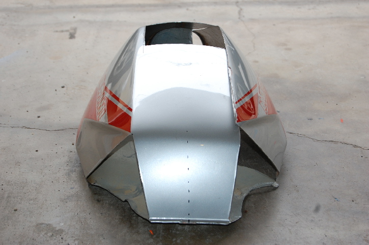

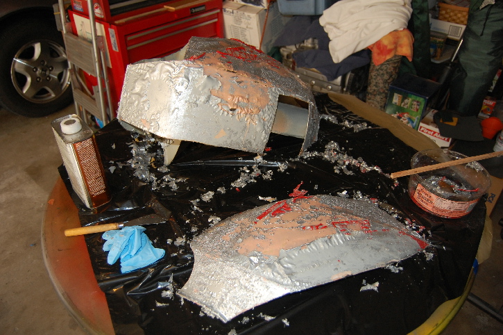

As I have sawed up my fuel tank for major modifications, I now see why the Morini fuel tank on my K-2 looked so nice...The factory coated the entire tank with body filler to smooth out the weld seams and any imperfections in the metal....Makes for tough stripping though.....

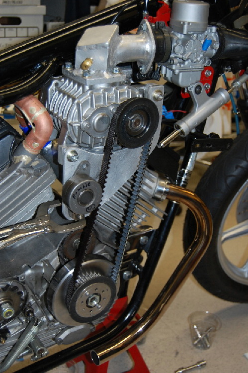

Making a tank with:
1- the rear corners trimmed off so my knees can tuck in.
2-the Filler cap moved to the left about an inch and made "flush".
3- right half of the tank will now only be a cover for the air filter, intake , and top half of the supercharger....
