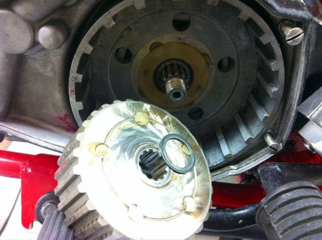

I adjusted the clutch spring nuts by bottoming the springs and then backing the nut off a 1/4 turn. The face of the nut now is about a thread or so below the face of the stud. However, it does not seem to have made any difference. There is crunching noise when I put it into gear and the rear wheel spins with the clutch pulled in. I tried it with the clutch actuating arm 15mm from the face and also with the arm as far away as possible from the case.
The inner clutch bell does not seem to be any end-float but did spin when I rotated it by hand after removing the plates. I pulled the bell off and checked that I had installed the nylon bush correctly (the 4 "ears" sitting in the allen key recesses). However, there is a steel shim washer in between the nylon bush and the clutch bell that does not seem to be in the parts diag. Maybe, someone installed it to shim away the end-float? I am attaching a photo of the bell with the shim and nylon bush and another photo of the plates.
- Morini clutch bell.JPG (129.26 KiB) Viewed 15523 times

Ok, lets assume yours is an early bike (you've never mentioned the year).
Very early bikes had no clutch thrust washer and a Bronze one was quickly introduced, later replaced with a plastic one.
The plastic thrust washer is thicker, so a shim has to be added for clearance where it has replaced a Bronze. If there isn't sufficient clearance, then the trust washer itself will create clutch drag.
There should be a thin film of grease on the thrust washer.

I assume you meant that the plastic washer was thinner than the bronze bush and that is why a spacer was needed? My bike is a November 1979 K with about 10k miles. The blue manual that came with it shows and talks about the "special" nylon washer but does not say anything about a shim or specify any end float. I did coat the washer with a film of grease before reassembly.

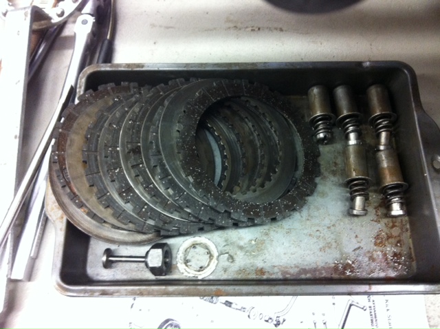

OK, a 79 bike should definitely have a clutch pack with a conical steel plate.
Can you stack the steel plates up and take an edge on picture.
The clutch centre hub tightens against the sleeve you can see in the middle of the outer drum. Without the spacer, the hub would be locked solid against the outer drum. The thicker plastic washer needs a thicker spacer.
With the hub in place (but no plates fitted) is there any drag between the inner and outer drums?

I looked in the box of parts that came with the bike and did find a thinner metal plate (along with used fiber and steel plates) that for some reason the previous owner did not use. I installed the thin fiber disk first, then the thin metal disk, and then the rest of the pack and tightened the screws down till the face of the spring retaining nuts were flush with the thread bosses. Before installing the plates, I manually rotated the the inner bell (having greased the face of the nylon bush) and bell turns smoothly on the nylon washer, while the outer drum remains stationary with no drag.
So now the all gears except first change without a crunch, take up is gradual, and the rear wheel does not spin with the clutch pulled in - yay! However, there is still a crunch getting into first that seems to vary in intensity as I move the clutch arm in or out. Finding neutral also seems to be a bit of a problem. Maybe, it is now a matter of finding that sweet spot where the clutch pushrod is bearing just the right amount on the plates.....

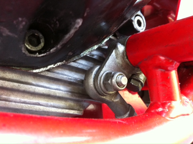

Re: Clutch spring retaining nuts (and gear linkage)
I've got it to the point where it goes into gear with a slight clunk. But it seems to bog down when I let the clutch out. Now, I am beginning to wonder if I have my gear linkage upside down
.My bike is 1979 K sold in the US and so I assumed it was sold with the left hand side gear (which it has) going 1 down and 2 to 5 up. However, even though I have restored several bikes I made the elementary mistake of not photographing the gear linkage thinking it was obvious how to put it back.
While the right hand side can only go back one way given the various bits and bobs that get in the way, the left hand linkage which directly attaches to the gear lever can (I now think) can go back two ways. I am attaching a photo that shows the short linkage on the left side that attaches on the top to the gear lever and at the bottom to the cross shaft that carries over to the right hand side linkage. The way I have set it up, the pinch bolt that retains the stubby link arm around the gear lever enters the boss from the bottom and the boss itself is to the rear of the gear lever. The other possibility would be for the boss to lie horizontally below the gear lever with the stubby link arm standing vertical behind the gear lever instead of angled below it (see photo).
Which is the right way?
Joe
Joe
- Morini gear linkage.JPG (111.82 KiB) Viewed 15467 times
