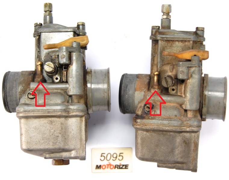

do your carbs have the brass fittings? If so: these are the balancing connectors... to what are they connected? They should be connected to each other with a piece of tubing...Bison wrote:Thanks Paul,
I'm running my valve clearances at .006" rather than .004", I'm pretty sure I have a stock Sport cam. Wouldn't take long to set them to the correct size though. Carbs are balanced both at idle and on the throttle, but I'll check them again. Don't have a balance pipe.
Alan.
a Guzzi friend also had a Morini and had problems adjusting his carbs... after a while we figured out that the balancing connectors were not connected and had small pieces of tubing that led out into the open... drawing in false air running the engine lean
- motomorin-1364578335-28013.jpg (111.89 KiB) Viewed 15749 times
Re: So, which one?
Hi Hendre,
No, brass connectors aren't there, it's just plain aluminium, no blanking plug or anything.
Alan.
Alan.
Re: So, which one?
The balance pipe was fitted to later models to make them less sensitive to carb balance.hendre wrote:do your carbs have the brass fittings? If so: these are the balancing connectors... to what are they connected? They should be connected to each other with a piece of tubing...
You remove the balance pipe to connect the vacuum gauges, but when you're done and put the balance pipe back the idle speed goes up.
Now you have to adjust the idle speed screws, but with no gauges to show the balance!
I take the balance pipe off and cap the ports. I find the bikes tend to run better.

Paul,
My balance connections are in the rubber/plastic inlet manifolds.
