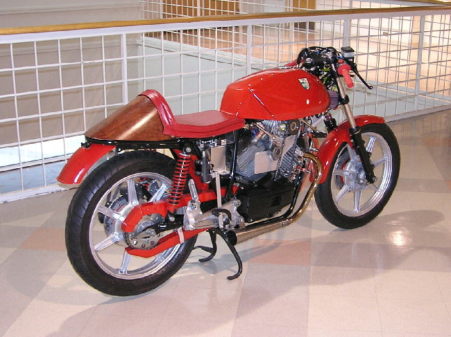

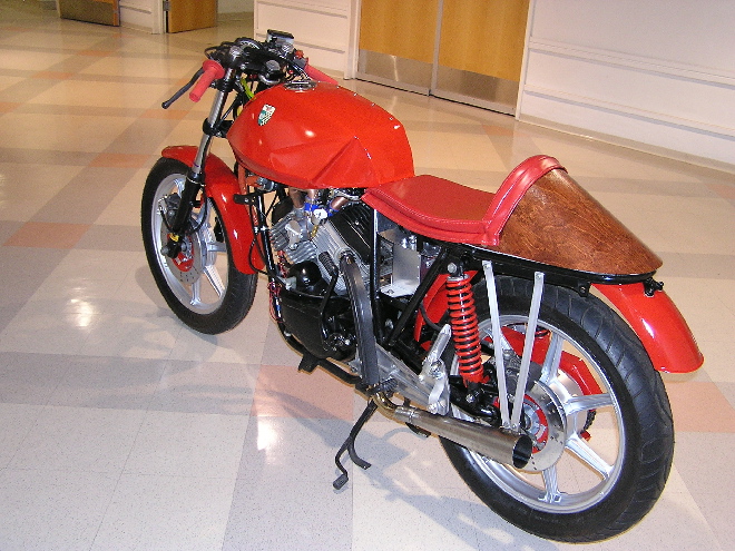

Here is a picture of how it looked before just before the first startup.... It is alot worst for wear now and will need repainting before May...
Robert

Wooden tailpiece!! Words fail me how classy that is ...
