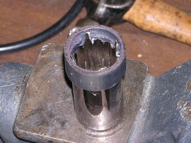

At the very least make a collar to /press/shrink over the outside of the modified socket to support the prongs.
The correct tool is made so the prongs are supported radially as well as axially.

Great suggestion on shrinking an external band onto the prongs to help support them....

Mad Muller made a great suggestion to shrink a band around the end of the home-made four prong tool for support....
Well, here is what it looks like....
Nut is still on the crank,,, Impact gun doesn't move it...
Tool didn't break and I'm happy with that...
Robert

Correction.... it was EVguru that made that suggestion.
