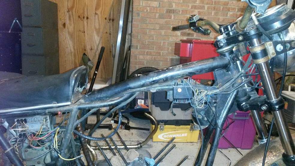

Top Tube pic
Top Tube pic
Looks bent to me, what do you think?

Oh, that's bent all right!
The intentionally kinked downtubes bend in the opposite direction and the top tube is straight.

:shock: this frame really is bended! Iwould say it is scrap metal :roll:

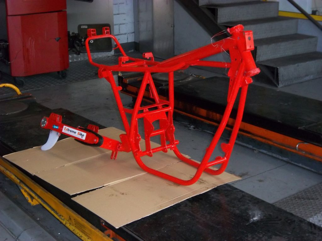

This is an old frame from ´74, without the knick. It´s modified, but you can see the two front downtubes are straight:

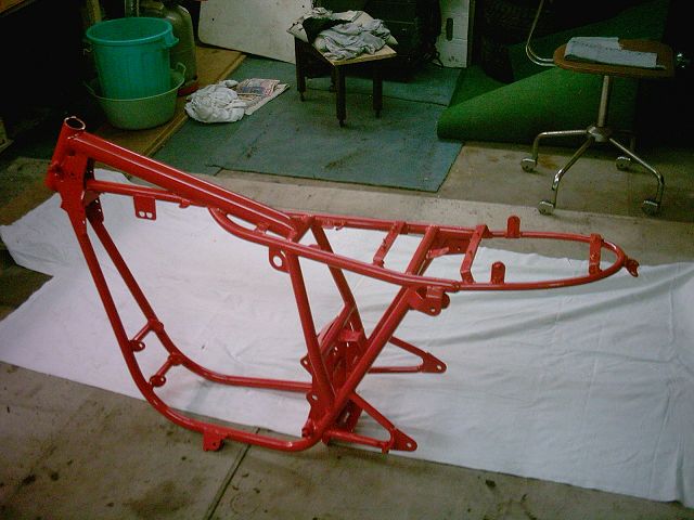

Meanwhile this is a knick frame, the two downtubes are slightly bended (the frame was also modified to build a racer):

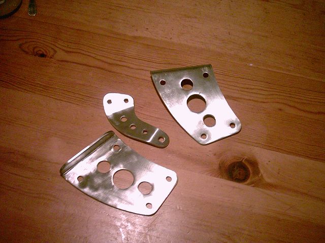

the engine plates of the older models without a knick look like this
The engine plates are diferent in sizes, you can not use the old plates with a knick frame or reversed.

"crash victim alert"
it is going to be pretty tough (not to say impossible) to get this on straight again...
