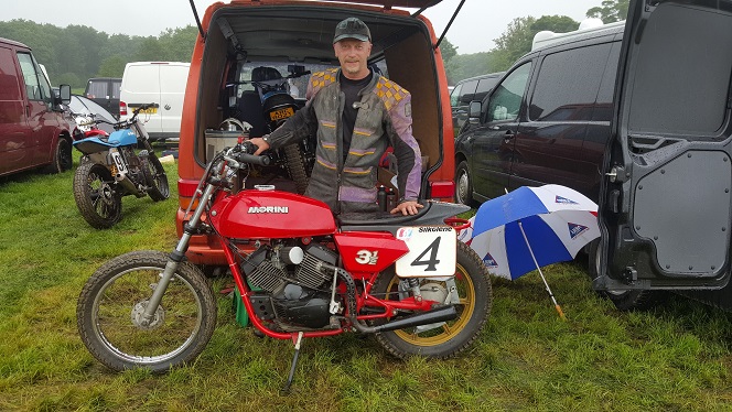

Do i really need bigger carbs to get the best out of the 400 conversion i am doing at the moment, Baring in mind i will be racing on fairly short 300m speedway tracks in 3rd gear, regards, Harry.

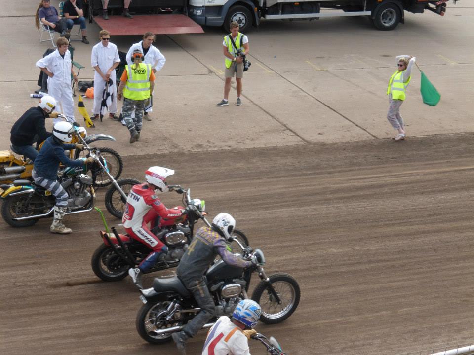

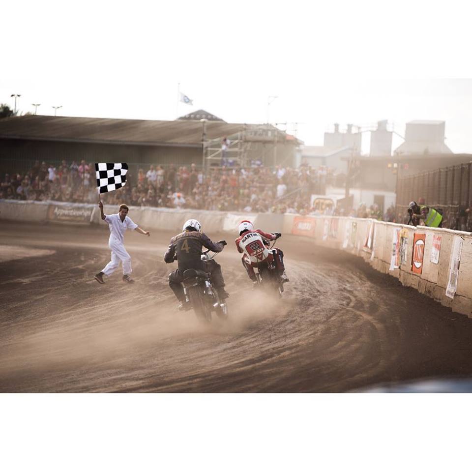

Thanks for the input guys, I have been told several times by wise old flattrackers that gearing is one of the most important things to get right, acceleration out of the corners is definitely more of a priority than top speed, so i will look for some 26mm's to start with. Im fast running out of time as i have a big meeting coming up at Kings Lynn Speedway on the 15th/16th, There are so many different opinions on filters and airbox's, i will just have to take it down the field and give it a try out for this week, It will be interesting to see how the 400 go's compared to the 80 psi 350 i rode 4 weeks ago, + re-cut seats and a couple of valve guides, hopefully a lot more punch, it seemed to run out of breath half way down the straight last time out, one point i could do with a bit of input on is ignition output, The Danish guy Seron who has several video's on youtube thinks that 180-200 ohms is enough for the output coil, mine starts well but Al Webber who runs a very nice 500 in the states seems to think its not enough and could cause a similar symptons as mine running out of steam, Supporters are always welcome to our races, Its some of the best action you will see on 2 wheels, and its free at most of our meetings,See http://www.dirttrackriders.co.uk for info. The picture is of Guy Martin just pipping me to the flag in the Harley Davidson race at last seasons Dirt Quake, an amazing meeting if you want to see just about any kind of motorcycle ripping round a speedway track, from R1's to a Honda step through.
				- 11896047_10154117868465968_3105776012158184836_n.jpg (95.51 KiB) Viewed 19043 times
				- 11742872_1145209022159087_5683532768427498235_n.jpg (61.63 KiB) Viewed 19043 times
Re: Bigger Carbs For 400 Conversion?
Looks like great fun, I'd love to see a Honda step-through ripping round a speedway track!an amazing meeting if you want to see just about any kind of motorcycle ripping round a speedway track, from R1's to a Honda step through.
The guy on the R1 is the one to watch, He comes up from the south of france for the event, He is an ex stunt rider and watching him come out of the corners sideways and then wheelie over the line is pretty good!

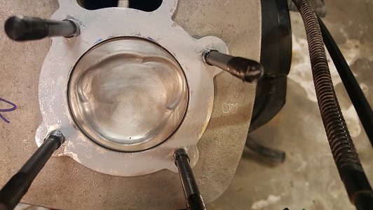

I think your right Muller. But i was hoping for more input i have to say, pretty disappointed with the armchair tuners! Went for a run on it yesterday with the 400 pistons in, feels ok, obviously still a bit tight, need to get some miles on it tomorrow, got a big race at the weekend, still feels like its holding back a bit so i might try another ignition tomorrow.  Picture of the vw piston.
