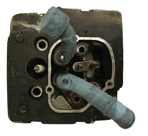

I just aquired a cracked 500 cylinder head for study, and I now know that the valves and ports in the 500 heads are just enormous compared to a 350's. I don't have exact numbers yet,
but the potential gains in airflow could be on the order of 35% or more under the right conditions,,,, turbo or NOS for example,,,,
I can tell you from my own experience that stock 350 heads with a "sports" cam grind have a maximum air processing ability of about 75 CFM at 7500 rpm under 10 psi of boost, and then they are DONE.... More boost or rpm does not result in more hp.....
As each single HP requires about 1.4 to 1.5 CFM real world flow,,,, that works out to 50 hp at the crank at 7500 rpm....
Does anyone know what the 500 turbo motor made HP wise ???? If my estimate is correct, I would say somewhere in the 65-70 HP range...
So, a short stroke 350 with 500 heads and pistons could really make power IF it can stay together at a high enough rpm to through-put big CFM numbers.....

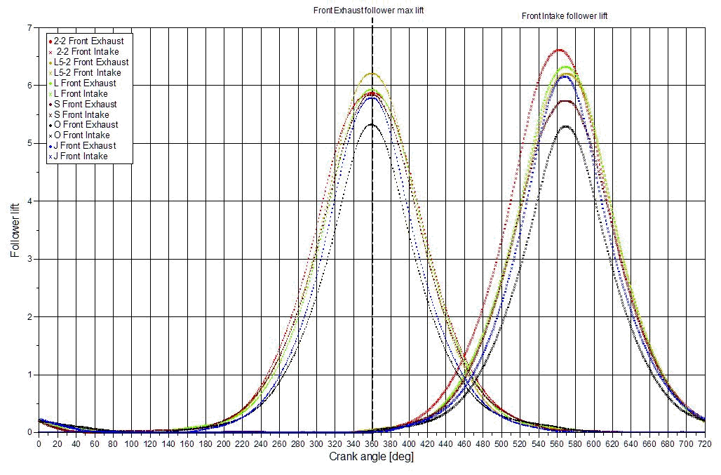

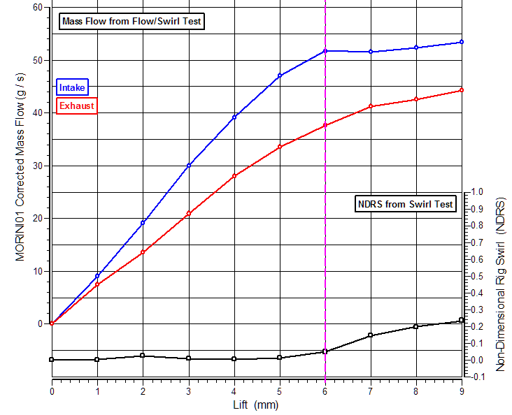

I can't help with info on a short stroke 350 but can share some data I collected when building up my 501 motor.
I was able to flow test and take port moulds from the standard 501 head. Also, I measured lift curves for all of the camshafts available to me.
Bear in mind the cam lift curves are knifedge cam lift so you would need to factor in follower width, profile, pushrod and rocker kinematics and rocker ratio to get true valve lift.
The sudden change in the gradient of the mass flow curve after 6mm valve lift (plateaus at ~50g/s at STP) suggests that possibly the air flow is detaching from the port and generating some kind of charge motion.
The magnitude of swirl is quite low although I never got the complete story as I did not do a tumble test, so it's not clear whether the charge motion is intentional or indeed beneficial.
As the performance cams have significantly more than 6mm valve lift, it's probable that their airflow potential is limited by the ports.
I went ahead and ported my head, although time constraint to get the motor built meant I never got around to flow testing it afterwards. Certainly feels like an improvement by Arse dyno though. Certainly on a short stroke motor a 501 (or 500 if you can't get a 501) head would be a big improvement.

Morini cam lift curves (NOT valve lift)

501 cylinder head flow
