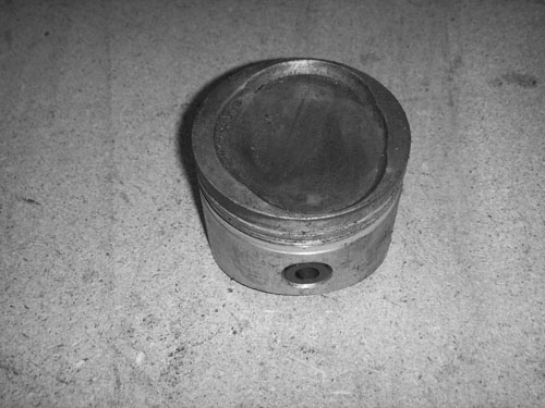

Do your pistons look like this? I have a set of barrels with piston like these and I'm pretty sure they're Guzzi. I have never run them and my main concern is that the Gudgeon pin is central, when in a morini, obviously, it is not. As such I guess the bad thing is they'll add some vibration. The good thing is they're available and were designed to run in nikasil, not iron, liners.
Oddly, though Guzzi ran heron heads in all but the 4-valve small block-Vs, they kept with very simple combustion chambers like this. They obviously thought the fancy design wasn't worth any measurable power advantage?

- Guzzi 66mm.jpg (62.9 KiB) Viewed 12902 times

Similar, but not quite, I'm hoping that Mark will let us see some photo's of his (I don't actually have any, yet)

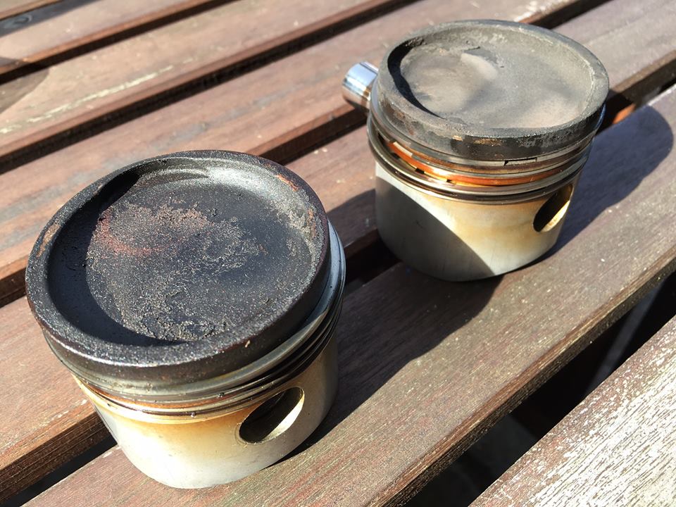

After giving up on Photobucket in disgust some time ago I no longer know how to post photos here. I've posted a picture of them on the Moto Morini Motorcycles facebook group so you'll see them there.

Re: 400 pistons
Or you can add them as an attachment like I just did.

Re: 400 pistons
This is the type that I have seen, Mark thinks that Alex at NLM fitted them, so it seems unlikely to me that they are VW pistons, but I don't know, what I would like to know is the various merits between the two types, are these able to take advantage of 500 sized valves more easily than the Morini type for instance, the theoretical performance differences between the two types etc. Someone out there must know.

PS. Looking at the photos above, my 400 pistons are also of the last type posted. Very close to the Guzzi 66mm pistons (I posted earlier), but just a little different.

Re: 400 pistons
Mystery solved it seems, Wee Vee imported a number of sets of barrels and pistons from Italy with the bowl type pistons, I have this from Benjy himself. If Wee Vee imported them it is not unlikely that NLM also did so. They are not Guzzi or VW pistons but who the supplier was Benjy cannot recollect.
