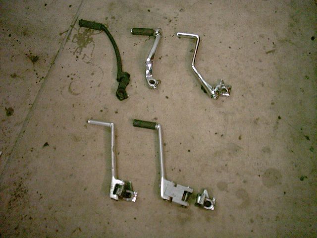

Posts: 929
Re: Tarozzi rearset problem
If you can get a k2 kicker the problem is gone :wink: They are made of steel, so you can heat them up and bend them as you like.
The one up-right is a bended K2 kicker
