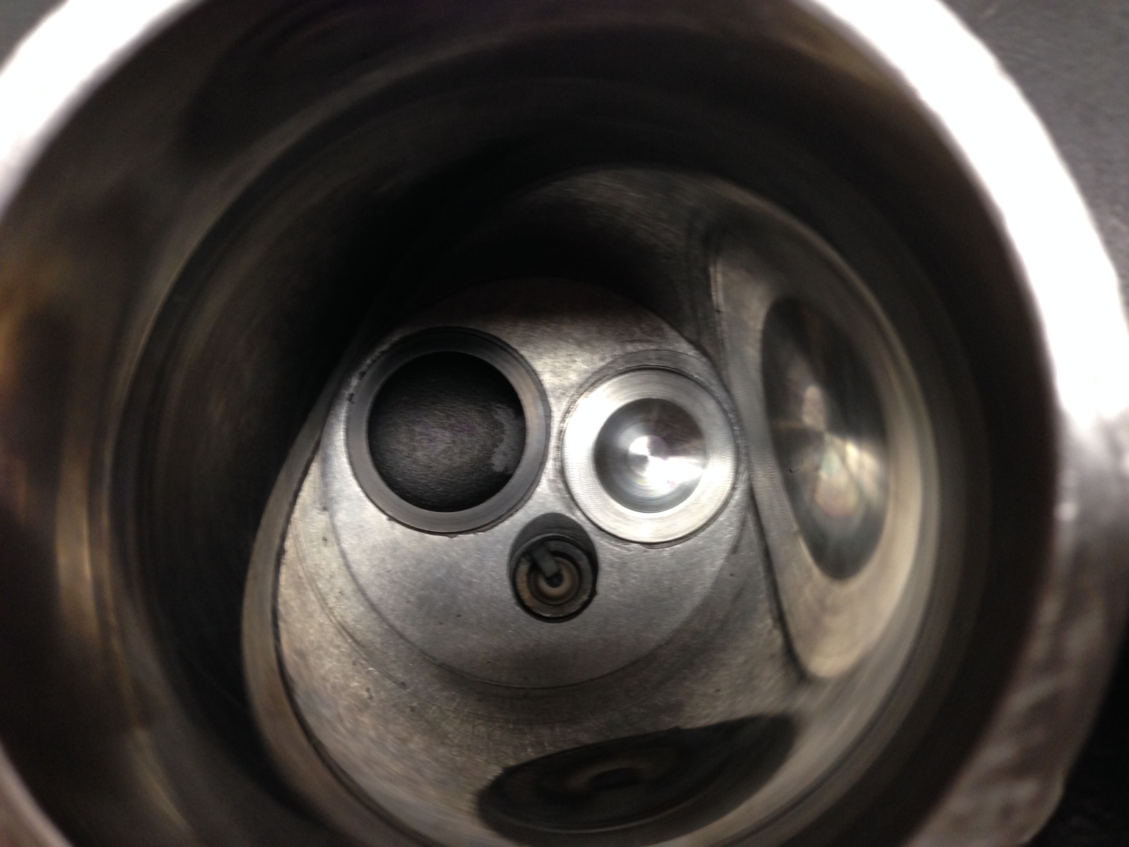

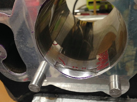

Re: 500 valves in a 350 Head
Hello Lads,
Here are photos of :
OEM valves within a stock 62mm bore
O/S exh valve and standard Intake valve in a 62mm bore
Notching the top edge of a cylinder bore in an attempt to "unshroud' the valve edge somewhat for better low lift flow...
[attachment=1]
