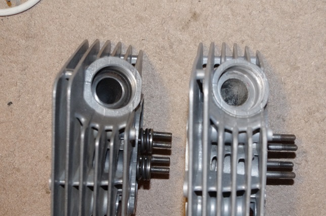

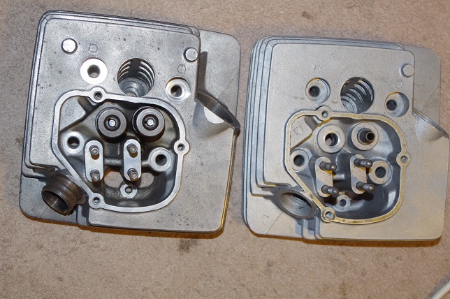

It so happens I have boxes next to me with 77? Strada heads and ?? Kanguro heads. Bad photo attached.
The only difference I can see is an extra casting 'lump' on the kanguro head (on the left) and a 'flat' on the top of the exhaust port. The rocker stud threads also seem longer (though the studs are the same length) - but they might be replacements.
The Forgotten Error has one 'old' head and one Kanguro head. So far as I can tell they are interchangeable - but perhaps the 'flat' on the port is vital for clearance if in a Kanguro frame?

Ah. There is also more 'meat' round the exhaust port on the Kanguro head (left). Not sure why. Perhaps makes for a better thread, or better cooling.?
