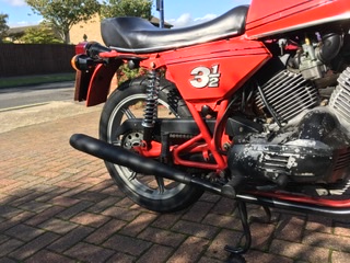

Finally cut off the extension pipe and fitted the Armours silencers. They fitted the standard brackets perfectly although I did have to slim down the nuts so they would slide into the brackets welded onto the silencers. I also had to run a drill bit through the clamp which is integral to the silencers so that I could get an m6 bolt through. Overall an easy enough fit.
They look good too and have a lovely sound, the engine seems to run better too but that may be the clean and refurb of the carbs.

Found the picture of your bike interesting. My 3 1/2 Sport has exactly the same colour scheme with black pin stripes. When my bike was imported in about 1999 it was given a manufactured date of 1983 in the V5C but component parts on the bike are dated late 1978. I believe my bike is either late 1978 or 1979. The frame number on my bike is A3 16413. Would be interested to know the frame number of your bike if you are happy to share it. Once you have sorted out the running I think you will have a lot of fun riding the bike - possibly the best bike I own. Carb balancing makes a big difference to the performance and running. The £15 I spent on a second hand Morgan Carb Tune II at the Popham Megameet was the best £15 I have spent on a bike in a long time! Enjoy your Morini.
