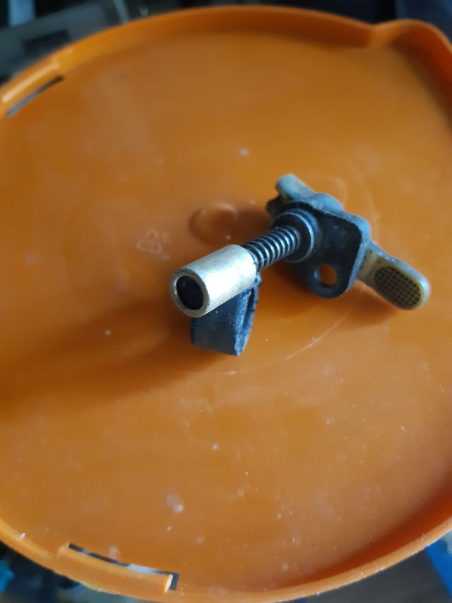

Worth removing the choke plunger and checking that the 'rubber' pad is still on the business end. Not unknown for these to go awol. The black circle on the end in the pic attached is the bit I'm referring to.
If it is still in place, is it still soft or set like rock? If not there, your bike will have the choke on all the time on that cylinder.

I’ve got a couple of new Viton pads on their way to replace the old rubber ones in the enrichment tubes. I checked the left one and the pad was very deformed so I’ll change both as a start.

Ok, fitted the two new rubber pads to the ends of the enrichment plungers. The old rubbers were crumbling and deformed. After a run out they seem to have made a considerable improvement, much smoother at lower revs. Now time to go over the mixture again as there’s a chance it’s not being enriched all the time.

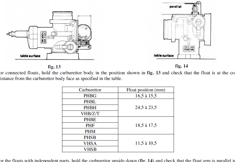

The float heights should be set according to the Dell'Orto manual @ 24mm +/- 0.5mm to the base of the float.
The method shown in the blue book is confusing and imprecise in my opinion.
