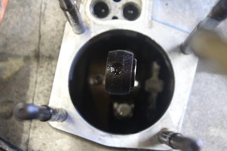

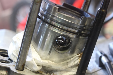

Finally got some time to investigate the problem, and it is what I had feared the whole time. The exact same failure as before, the gudgeon pin clip broken up and the pin allowed to drift and cut a groove into the cylinder wall. A newly rebored cylinder wall. Rats.
Looking at the conrod, the small end bush has moved. There is a lot of side play (not up and down) with the conrod on the crank. I don't know if this is normal. I have no comparison but I would say the conrod bearings are shot, putting lateral pressure on the gudgeon pin and piston, and melting the side of the piston. That’s my theory anyway. The rings look fine though, and the piston was fitted in the correct orientation. The brand new 375 piston. Rats.
I haven’t looked at the front cylinder yet. I’m at a crossroads; try and rebuild the bottom end with the limited time, experience and tools I have, look for a replacement engine, or take it to Lusso Veloce and spend more than what I paid for the bike. Also, I believe that this wasn't even the cause of the idle issue, so factor in new carbs too.
Or I sell the damn thing. I’m gutted. Once again, thank you everybody for your help and encouragement with this one.

That's such a shame, but there is something fundamentally wrong here.

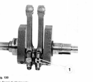

Tell me that the rear con rod is the right way round?
The two larger parts at the bearing end should face each other.
A common mistake is failure to relieve the radius of the big end bearing shell at the crank web side, which causes the conrod to bind.
The conrod clearance side to side play is 0.3 to 0.45mm.
I think that you should take it to someone who can measure such things as straightness
of the conrod and bearing clearances. Then make a decision.
Gutted for you too.

Well that explains the tinkling noise I guess.
The only part of the Forgotten Error engine rebuild I didn't do myself was fitting the new rods after the crank re-grind and timing side roller bearing conversion. I left that to Ollie at NLM.
Otherwise, it's a much less complex bottom end job than some I think. It's the only one I've ever attempted other than a 1929 350 Raleigh.
You can workaround some of the special tool requirements with ingenuity. Do the club still have a tool hire scheme? I have no plans to use the holder and extractor that I purchased, so you could borrow those.
Plenty of folk here to ask for help and Evguru videos to watch.
The problem, however, is that if, as seems likely, it needs new rods, there are none to be had. I had the last pair NLM had on the shelf (the big end eyes had gone oval on mine). Even good used ones aren't exactly cheap, and there's the regrind to factor in. Pistons and reboring . A whole set of bearings and oil seals is pretty reasonable though. I stopped keeping an excel tally of what my engine rebuild cost or I might have abandoned it. Still cheaper than paying someone to do all the work.
Tough decision. The only upside is that an eventually sweetly running Morini 350 is a joy forever, and even more so if you can get it that way yourself.

That is a gruesome sight. Not a place any of us wants to be in. I have had something similar but that was on a car, remedied in that case by a simple but expensive engine replacement. There are some rods on eBay in Italy at the mo, don’t know any more than that. As said already there must be an issue which lead to this failure. Let’s hope someone can help.
It’s going to take some money to assess and fix though.
