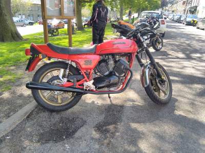

Mine are a sort of dirty Caramac colour and I have seen some that were a sort of oil seed rape yellow which was a bit bright!

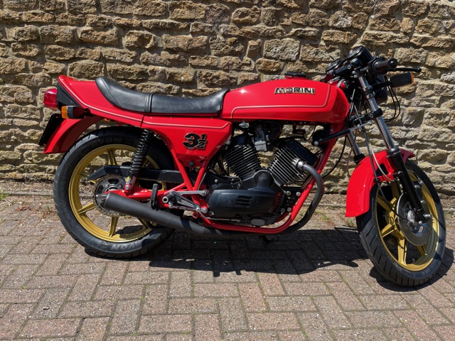

If you’re in the UK, I just had my wheels re powder coated by central wheel.
Central wheel don’t have a RAL number but their colour I went for was ‘bonded gold’
Not a perfect match for the original- a bit more metallic and less matte baby poo, but it’s a convincing effort i would say.

That looks like a pretty good match Tom, I’ll give them a call.

I just noticed that if you put into google « powder coat paint colour bonded gold » Pearl Gold Ral 1036 comes up.
So Tom’s wheel colour must be pretty much the same as Soren’s recommendation.
Yes, I know nobody cares, just saying . . . .
