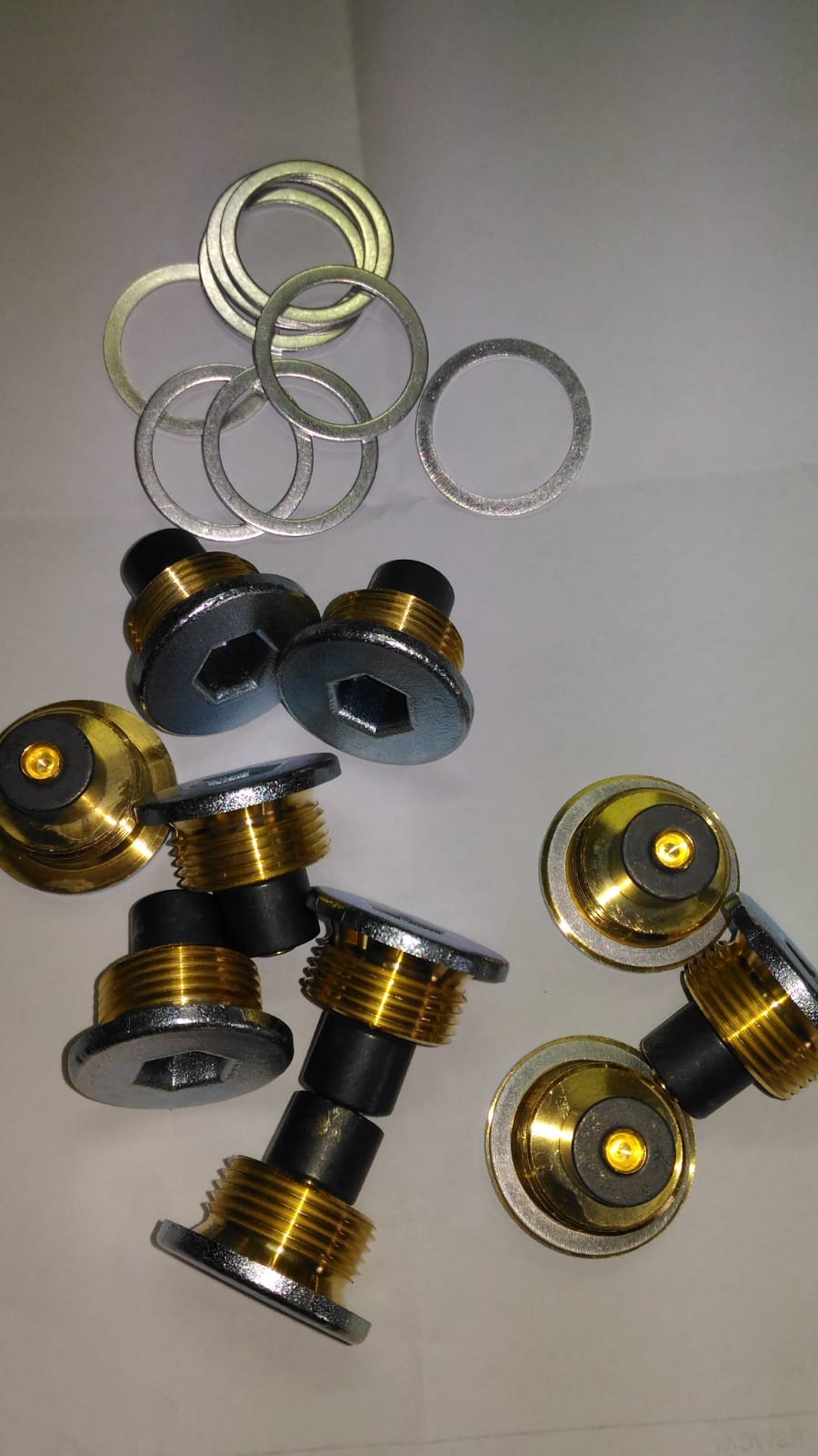

For the future better try these from Ducati Monster.

P&S
Posts: 84
Joined: 21 Oct 2017 18:18
Location: Rome Italy
Location: Roma
Re: Separating crankcases
Post by P&S »
Thanks!
